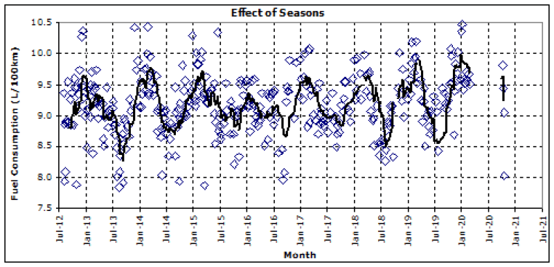

Just to underline the point made, here is a meticulous account of the measured fuel consumption of a 4-cylinder sedan (mine) driven for 6 years.
The fuel consumption in the summer is in the mid-8 L/100km. In the winter it's in the mid-9 L/100km. Seasonal variation therefore about +/-5%.
So in context, some range and efficiency loss to an EV is nothing new or special compared to a gasoline car.
The real change is just that nobody has been paying attention all this time.
Note: These values are not the imaginary numbers on the digital screen that all cars with fuel computers including mine display to their drivers. These values are measured at the pump using calibrated and temperature corrected volumes, and on the odometer that is also calibrated frequently using highway test signs.
Note: I have checked several models of cars and the fuel consumption displays all underestimate by 10%, including mine.
Note: There is a substantial gap in my driving through most of 2020.
Note: There is a trend in the yearly average from about 9.0 in 2012 to 9.4 in 2019 that represents the aging of the car.
Is that driven from new? I typically see a 10% fall in the first 1000-3000 km which I attribute to the diff (in particular) running in. However cynics may suggest that in the first few weeks I mess about a lot more than I do later.

It's a 2008 car. I bought in 2012 when it had 140,000 km (87k miles) and I've got it up to 380,000km (237k miles).
I "mess about" lots in the summer because of the better traction. I also "mess about" lots in the winter... because of low traction... :\ it's a fun car with a 6-speed manual gearbox. Lotsa choices.
