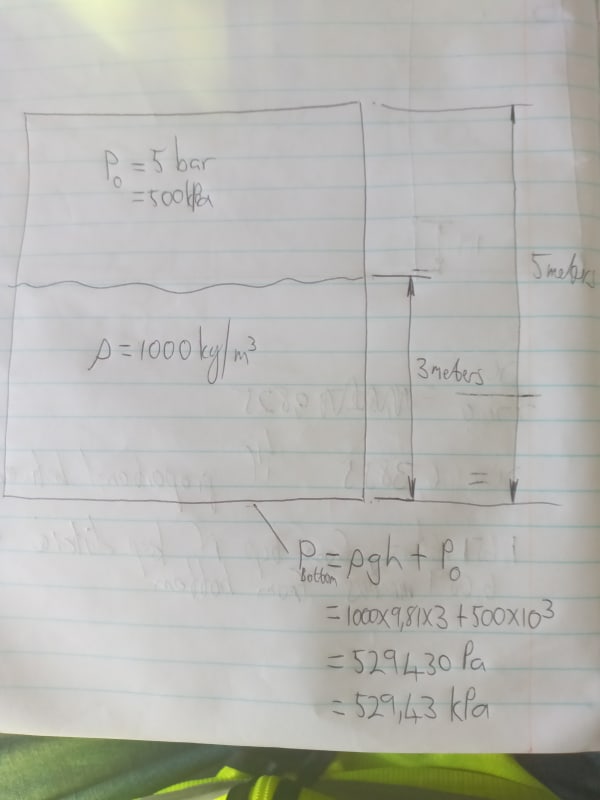

Please help settle a discussion…
As per the picture, can you increase the pressure in the water by increasing the pressure in the air above? It’s a sealed container.
If yes/no, why?
I thought you couldn’t, due to P equaling rho x g x h. But someone else reckons you can, and I’m second guessing myself.
Thanks.

bimr, You absolutely can increase the pressure in a closed volume containing only liquid. This is a very common method of pressure testing piping and vessels using water.

No, this is not why atmospheric pressure can be neglected. It can usually be neglected because we tend to deal in gauge pressures where atmospheric pressure is by definition zero. From your Hydraulics 101 link:
p-p_a = rho*g*h
and almost always we measure pressure as gauge pressure, relative to the atmosphere, as shown in Figure 2-4, so that we usually just write
p = rho*g*h (2.6)
In the above, the subscript a refers to atmospheric pressure because the system is open to atmosphere, so the pressure above the liquid column is always atmospheric. But in a closed system p_a can be something higher than atmospheric pressure and can't just be eliminated. Eqn 2.6 as presented in your link is dealing with a very specific subset of Bernoulli where there is 0 velocity and 0 static (gauge) pressure. In this case, the total pressure does reduce to just the gravitational head.
In a closed system eqn 2.6 above becomes p = p_a + rho*g*h or (total pressure) = (static pressure) + (gravity head).
Latexman is absolutely correct.

Both the air and water pressure in a sealed container could be increased by heating.
If there any remaining doubts, see any typical pump NPSH calculation taking water supply from a pressurized tank. The calculation done at the point of entry to the pump inlet, well away from the tank, indicates that the water's pressure includes the tank's pressure, not only water density x height of the water column.

No, you would be increasing the pressure in the sealed container, not in the water. Water is considered to be incompressible material like steel and other materials. If you put a piece of steel in the container instead of the water, would the steel pressure increase? No.
Water is indeed compressible, not at lot, but it is compressible. That being said, the (in)compressibility is completely irrelevant to whether the pressure in the water will increase or not if the air pressure is increased above it.
And it also doesn't matter if you replace the water with a piece of steel. Will the steel "feel" the increased air pressure? Of course it does, it is called material stress due to an externally applied force (pressure times area). The pressure inside the steel increases, due to a balancing effect between the internal forces and the externally applied force (being the air pressure above it). If the steel or the water would not "feel" the pressure increase, it would mean the whole system would be out of mechanical equilibrium and the bottom of the container wouldn't feel this pressure increase (and that doesn't make much sense, doesn't it)?
bimr (Civil/Environmental) said:
If you add compressed air to the container half filled with water, the air is on top of the water and that causes the pressure to increase on the bottom. From the compressed air not the water.
It really doesn't matter where the initial increase of pressure is coming from. The increase in pressure will spread throughout the complete container.

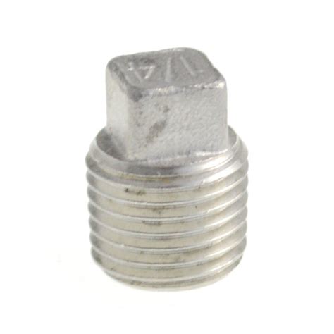

If you are worried about leaks from the little air purging valve then maybe just get a little screwed plug that you can screw into it with thread tape. It helps. It probably won't leak though
