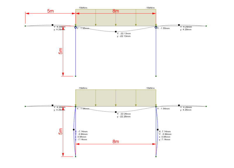

It took me about 5 minute to draw this up:
Same loading, same members, realistic member sizes, acceptable beam deflection. In one case the columns are bending like bananas in an unacceptable manner the other they are dead straight because they are pinned connections.
The columns do not appear to be "bending like bananas in an unacceptable manner." That looks like reasonable deflection to me.

To be fair if you are going to model the top beam/column connection rigid then should probably also model the column base connection as rigid or a rotational spring. Also should probably have a rigid end offset between the beam and column to move the attachment to the beam base, the stiffeners will take care of the panel zone deformations.
Your model deflections for the beam are actually quite similar so it would seem that in isolation designing the beam as pin-pin would be accurate.

The lateral deflection of the column at midheight is 7.14 mm. The height of the column is 5 m, or 5000 mm. The deflection of the column at midheight is H/700, which is well within the allowable deflection limit for any building material, including masonry.
If you wish to go through the exercise of designing this as a rigid frame, I have no problem with that. It will be more accurate than assuming the top of the column is pinned. My point is if you assume the top of the column is pinned, it won't make enough difference to justify the more sophisticated analysis.
