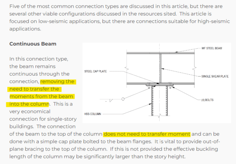

Typical cap plates for pipes will have bolts around the pipe, is there a way to release moments in that type of cap plate?

I put no stock in the blurb shown below when it comes to this debate.
What the STI blurb is saying (poorly) is that, with the beam continuous, the designer can obtain the lion's share of the benefits of continuous framing without the need for a beam-column moment connection.
The STI blurb is not a carte blanche endorsement that it is always and forever ok to ignore incidental fixity at these connections.
KootK - I agree, especially when you consider skip loading.
Yes, while it suggests that the cap plate doesn't need to be designed specifically as a moment connection, it doesn't imply that it won't transmit any moment and that the column design needn't include moment.

1) Accept that, in the real world, there will always be some moment transfer. Even with no welds or bolts, the connection will transfer some moment as a result of the connection being prestressed by the load.
2) Accept that structural engineering is about the moderately intelligent, rough proportioning of things. We "know" nothing and need to be honest with ourselves about that. I'm looking at you John Snow.
3) A skilled designer keeps the moment transferred through the joint small by exerting intelligent control over the relative member stiffnesses. In many applications, a stiff beam run over top of a slender column will wind up transferring little moment through the beam-column joint. Software has become a problem in this regard. Designers tend to build their models and then just push the "optimize weight" button or whatever. This is how you wind up with the odd W6 beam run over top of an TS8 column and creating a joint moment transfer problem. This doesn't often happen to engineers that know their craft. I believe that DaveAtkins and driftLimiter have both alluded to this same concept to some extent.
4) Recognize that the governing mode of failure for many gravity columns is not cross sectional stress but, rather, inelastic buckling. In many of the scenarios where these types of connections are used, the same connection that exerts a bit of moment on the columns will also serve to rotationally restrain the columns at the joint. So K=0.7-ish rather than K=1.0 or whatever.

FWIW every firm I've worked for (reputable firms) would design the members as if there's a hinge at the top of the column and create a non fully-restrained moment connection by using:
1. a non-thick cap plate;
2. non-large bolts; and
3. one set of stiffeners at the column centerline.
If the detail had a beefy cap plate, large bolts, and two sets of stiffeners like shown in the OP, then I might take the continuity more seriously.
I can get behind 271828's approach with the wimpy cap plate and only one stiffener. My only concern is you are counting on a member to potentially yield while deflecting in order to justify the release of the moment. The beam rotation has to go somewhere, and having it dissipate in the cap plate by the time it gets to the column seems suspect to me after a few cycles of heavy snow loading or a bridge crane going to the end of a runway.

Same for the firms that I've worked for. That said, I feel that approach serves mainly to obfuscate the important truth of the situation which I feel is this:
In many practical situations, appropriate joint modelling has more to do with what's going with the members coming into the joint than with the restraint offered by the joint itself.
Even a "wimpy" beam over column connection will transmit plenty of moment before something starts to give way. That, particularly, when one considers the joint prestressing effect.
With regard to the stiffeners:
a) A single pair is an appropriate, economical choice if the purpose of the stiffeners is rollover resistance, as it often is with small scale stuff.
b) A double pair is much better if the purpose of the stiffeners is transferring a significant column axial load into the beam. For this, one obviously wants the stiffeners over the parallel HSS walls.
c) I feel that stiffener selection should be informed by [a] and alone, without any regard to attempting to create a faux pin. I see little point in sacrificing legitimate design goals for others that cannot be reasonably achieved.
