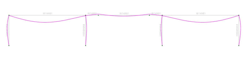

I ran a Gerber frame on RISA-3D. 30' column spacing, 12' high columns. I put 1.2 KLF load on the beams, for the D + S load combination.
Even though the columns deflect, they do not receive any moment. The moment in the cantilever equals the moment in the backspan. So maybe we are arguing over nothing?

Dave - did you unload the middle span?
I'm not sure I understand quite how no moment is transferred if the column deflects....

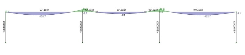

I stand corrected. There is a small moment transferred to the column (1.8 kip-ft). You can see that in the moment diagram above, but it is easy to miss because it does not show up graphically. If I load the middle bay with only dead load, the moment on the column becomes 3.5 kip-ft.
DaveAtkins
It's fuzzy, but it looks like there is 1.8 ft-kips of moment at the top of the center columns and 3.1 ft-kips at the outside columns.
*Edit, looks like Dave beat me to it.*
Dave - Are you sure that the column axes aren't turned 90 degrees such that RISA doesn't show any moments on your display? (Z vs. Y moments)
Hooke's Law - if there's deflection there's moment.
