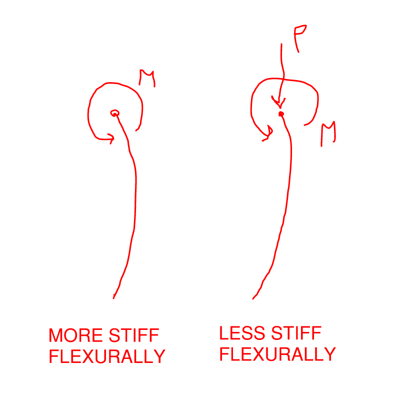

A column with axial load will be softer with respect to apparent bending stiffness than will the same column without axial load. As the axial load of the column approaches Pe, the flexural stiffness of the column approaches zero. This is not something that will show up in a first order model of course. This drop in column stiffness will mean that the column, and the connection, will tend to draw less moment that would be predicted by a first order elastic model.
The drop in column stiffness won't add up to to much until the axial load gets pretty high. That said:
1) Conditions of high load are precisely where one would expect real world problems to manifest themselves and;
2) Proportioning gravity posts to be slender with respect to the supported framing will tend to exacerbate the trend.
