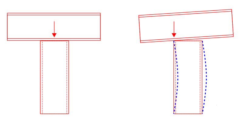

Typical cap plates for pipes will have bolts around the pipe, is there a way to release moments in that type of cap plate?

Consider the simplified case of a column without any cap plate or connection to the column whatsoever. As soon as the beam experiences any rotation at this joint there will be a moment induced in the column even if there is no moment transferred from the beam to the column. It is simply a matter of where the beam's reaction occurs relative to the centerline of the column. The only way to prevent this would be to provide an actual pin/rocker/what-have-you. Providing a very flexible cap plate (1/4" thick for example) will not prevent this. Providing a very thick cap plate would increase the induced moment as the reaction moves even further away from column CL.
Similar to how moment is induced in a column in the case of a shear tab welded to the face of the column. For example, RAM Structural System / RAM Steel column design module always considers this eccentricity from the face of the column (d_col/2 + distance from face of col to shear tab bolts). It takes into account the maximum effect caused by a beam loaded fully on one side of the column and no load on the opposite side, or whatever combination of attached members.
Just food for thought. What say the hivemind?
The moment induced in the column is moment taken away from the beam. The point of contraflexure is shifted to the point of eccentricity.

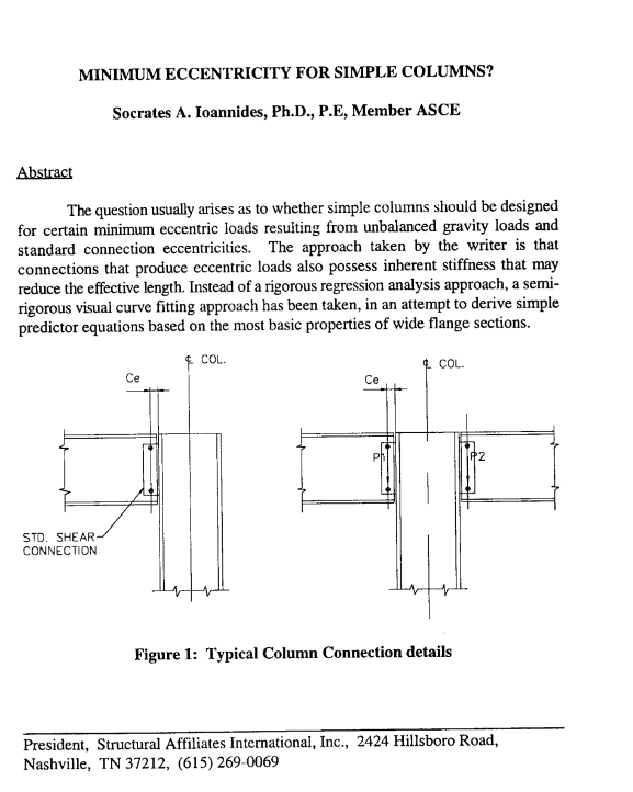

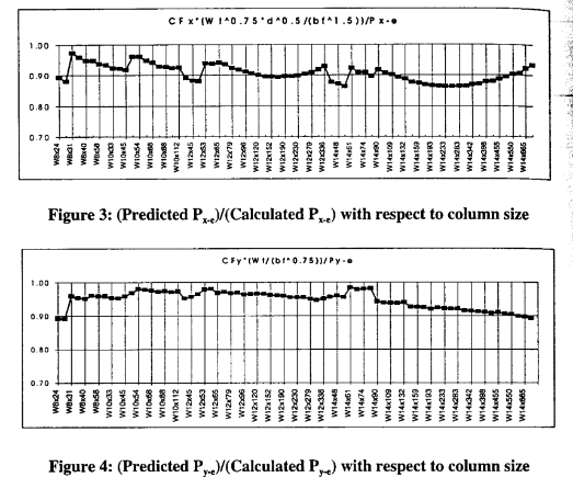

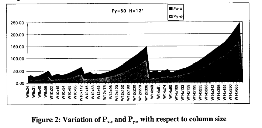

I'm going to post some literature on a related topic: the appropriateness of ignoring column eccentricity for simple beam shear connections. It's not my intent that this be taken as any kind of silver bullet supporting any particular position. It's just information that I feel belongs here and may be of interest to some. I picked up the Ioannides article back in 2000 when I had my first freakout over this.
Steel Interchange article discussing the Ionnides article: Link
Some clips from the Ionnides article which I can supplement if desired (still under copyright). Ionnides put some numbers to things and, effectively, comes to the same conclusion that is evolving here: incidental moments can often, but not always, be ignored.
Needed or not, I'd still prefer to have code provisions similar to some other countries that insist that eccentricity be taken to the bolt line. That kind of stuff is tough to enforce in a marketplace where it's optional however.
