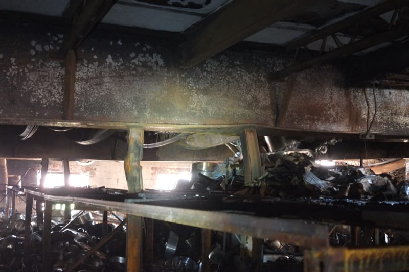

Just for fun, here's something I saw - a tiny column fixed to a massive W36 taking on some unintentional load transfer, twisting its big brother out of shape:
