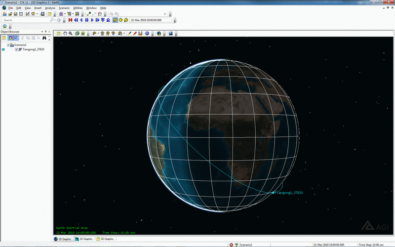

I know that if the satellite (With its upper stages of the assembled missile) is not adjusted once in orbit by additional motor burns, the furthest north and south of the orbit are determined by the latitude of the launch site if the missile is launched due east to take advantage of the earth's rotation. But what orbital dynamics force the actual path to oscillate between its furthest north and south points?
From logic, I can't figure out the forces that would make an orbiting body launched due east to move back across the equator.
Racooke, not clear what you are asking, so I'm probably rambling a bit here:
What causes orbital perturbations? A couple of things - gravity tides from the moon and sun will tend to pull on a spacecraft in a purely equatorial orbit, shifting its orbital plane over time. Also the gravity field of earth is not uniform, there are some significant mass concentrations (google image search for earth gravity map) that perturb spacecraft orbits.
But Tiangong was not in a purely equatorial orbit, it was launched at a latitude some distance above the equator, so it orbits at an angle to the equator. Not all spacecraft are launched due east, necessarily, they are launched and gain velocity in whatever direction you want the final orbit to be in, or whatever vector the rocket engines pushed in, hopefully those were the same. If launched from say, 45 deg. N, earth's rotation only gives you some 70% of the eastward velocity vector that you get at the equator, which is significant, but it's still only a fairly small fraction of the velocity needed for a stable orbit. And remember, the orbit has to be centered on earth's mass, so if you launch :due east" from 45N, you will still end up in an orbit with at least 45 deg. of inclination, your extra east velocity ends up pushing your orbit inclination more northerly. You might need to grab a ball and some rubber bands to help you visualize it, or a good map with "great circle" shipping/flying routes shown on it. In general, the minimum fuel to low orbit puts you in an orbit with an inclination close to the launch latitude.
FWIW, it's not "intuitive", it takes a bit of study and/or practice. Watching my kids figure out Kerbal Space Program was a lot of fun - and I was surprised how quickly they started to figure this stuff out. Now #2 son is off doing some programming to put KSP-type interfaces to work for real spacecraft.
"...forces that would make an orbiting body launched due east to move back across the equator."
It's moving in an orbital plane, it's just that the orbital plane is inclined to the Earth's equator. As you hinted, that's due to the latitude of the launch site (unless actively compensated).
And it's not sync to the Earth, so the equator crossings move around the Earth in longitude.
Basically, put away the map and refer to a globe. It's actually fairly simple referenced to a globe. :-)
PS: A good example of an orbit that looks insane on a map is the Tundra Orbit, used by Sirius satellite radio. Viewed against a globe, it's just (as expected) an ellipse.
