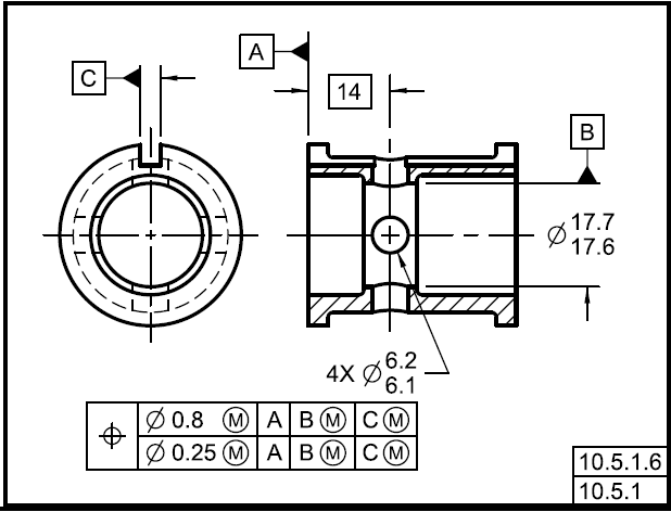

Hello,
First time posting on here. I'm working on a drawing with a group of holes that I want to control as a pattern using composite position. In the feature control box, the goal of the second line is to control the pattern's parallelism to the two datum holes. Is this the correct way of doing such or would it be something like A | B-C in the feature control box?? The actual part I am working on is not a simple rectangular shape, rather something a little more complex but I figured this was good enough to get my point across. I know I could add another datum to say, the top of the part and have parallelism to that but was wondering if I could do the same thing using composite position.

This has not been discussed so far (I omitted it intentionally too and hope that this time I read the drawing correctly ;-]), but the way datum feature symbol A is shown is incorrect per the standard. The symbol shall not be placed on center lines, center points, etc - it needs to indicate a physical feature of the part.
pmarc said:
Does it have anything to do with a belief that repetition of the same datum features in the lower segment of composite FCF as specified in the uppermost segment is not allowed?
No. Not at all.
It is allowed and more important, it is even mandatory in some cases.
I am thinking that B by itself in the second segment does nothing. Also C, by itself, as tertiary, does nothing.
But I am not understanding how B|C| --again B secondary and C tertiary--- is able to "do something" in the composite.
Same idea, as in 7-43/2009.
B by itself in the secondary, does nothing....But if C is added (C by itself is able to stop remaining DOF which was not stopped by A)
The main difference between 7-43/2009 and OP's picture is that C is able to stop a rotation a DOF in 7-43
versus
C is not able to stop (again by itself) any (none) DOF's in the OP's picture/ case.

B and C only apparently do nothing in the lower segment. Together (B secondary and C tertiary) they assure that the part's relationship to the DRF established from the datum feature simulators A, B, and C is the same in both segments.
So, looks like if only A is added in the second segment won't change the meaning nor the definition of the drawing? No need at all for the lower (third) segment.
Do you agree?
What is the point of having 3 segments in this particular application?
Do you agree?
No, I don't agree with that.
The third segment refines spacing between the four features in the pattern and their orientation/perpendicularity to datum A. But it does not constrain rotation of the framework of four tolerance zones in plane A - this is what the second segment is doing.

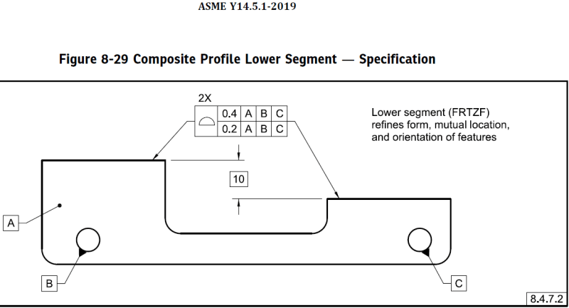

I'm proud to say that we addressed this particular case in Y14.5.1-2019. I included an example in the profile section, that has a composite profile tolerance with a datum feature configuration identical to the OP example. Here are the relevant figures, that show the drawing spec and the final optimized system:
Note that because of the A|B|C sequence, B defines the XY origin and C defines the w rotation of the X axis. The B simulator expands fully, and then the C simulator expands. If the sequence was A|B-C|, then the B and C simulators would expand simultaneously and constrain the X, Y, and w DOF's together. The resulting DRF would be slightly different in this case.

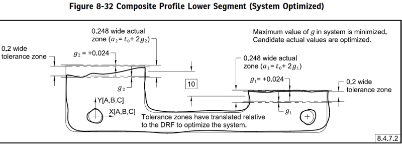

I am apparently really far out of my depth, I cannot visualize (and the example axym provided (fig 8-82) is not helping) how to interpret a composite tolerance that repeats all datums in order with simply a tighter acceptable range. Why does the 0.248 actual not violate the second segment tolerance (aka what did the 0.4 tolerance accomplish in the first place?)?
BiPolarMoment,
What that figure shows is that there are two 0.2 wide tolerance zones, associated with the second segment, basically oriented to the DRF and spaced apart by basic 10. These two can float in location, though. They are called the FRTZF. But, the two surfaces shall also fit within the first segment's 0.4 tolerance zones - the PLTZF, which are not shown on that figure, and they cannot float relative to DRF. They are basically oriented AND located to the DRF, and also spaced apart by basic distance 10. From looking at the figure it looks like it shows a non-conforming feature and the 0.248 actual zone does violate the second segment. Looks like the left side surface can't fit within the 0.2 tolerance zone, despite the "optimization" attempt (done by letting the FRTZF float).

Your interpretation of FRTZF's is exactly what I eventually landed on after studying the standard for a long time - the zone framework acts differently (it translates relative to the DRF). But I've found that this interpretation is probably in the minority (even in the Y14.5 committee itself). A lot of people have arrived at a different interpretation that is similar to what greenimi described - that the lower segment datum features act differently and only constrain rotational DOF's. We can find pieces of evidence in the standard to support both interpretations (and probably more for the second one, such as the "certain repeated datum feature references may not constrain any degrees of freedom" which was added in 2009. But it turns out, as you have determined, that if we test both interpretations on actual examples (including 10-43 and 10-44) then only the "zone framework translates relative to the DRF" interpretation is workable.
Your response to BiPolarMoment's question nailed it as well. My figure from Y14.5.1-2019 only shows the FRTZF and not the PLTZF, and the feature is nonconforming.

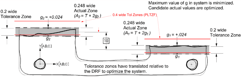

Here is a marked up version of Figure 8-32 that has the upper segment tolerance zones (PLTZF) drawn in. I decided not to include the PLTZF in the published version, because the figure has so much going on already.
This shows what Burunduk described. The 0.4 mm upper segment zones (PLTZF) are centered on the true profile, they have not translated. The 0.2 lower segment zones (FRTZF) have translated downward to optimize the actual value. The little red arrow above the 10 mm basic dimension represents how far they translated.
In this example, both the 0.4 upper segment tolerance and the 0.2 lower segment tolerance are nonconforming.
