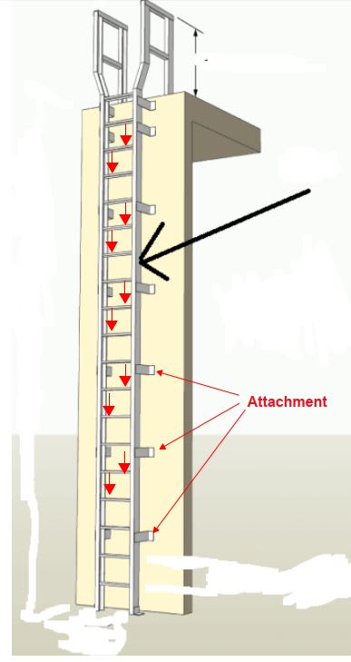

Can i have some advice on design of ladder stiles.
thanks

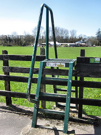

When you say "stile", I picture something like the attached, which seems to be different from what you're doing. So what exactly are you designing?
I've seen the 'side rails' referred to as 'stiles.. not often, but has happened. I don't know if 'side rails' is the correct term.

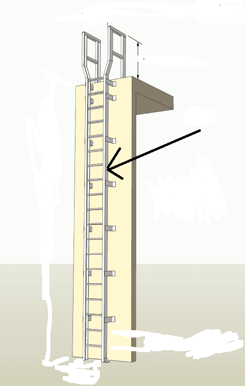

The arrow shows what i am designing in the ladder
dik,
I'm not familiar with the ANSI A14.3 - what's the purpose of the (2) 250 pound loads on adjacent rungs? Are those loads vertical only, or are they a moment couple?
I'm not sure... just to provide an extreme overloading? You would think the agencies could put their minds together and come up with a uniform loading requirement.
On the original diagram, it looks like you're checking moment in the ladder without considering the intermediate supports.

I would interpret that note a little differently. Attachments are not rungs. See below.
Also, 1.2kN is 270LB, not 250.
BA
BART... I think you're correct and have adjusted my notes and program to suit. and load was changed to 1.1kN... thanks.
