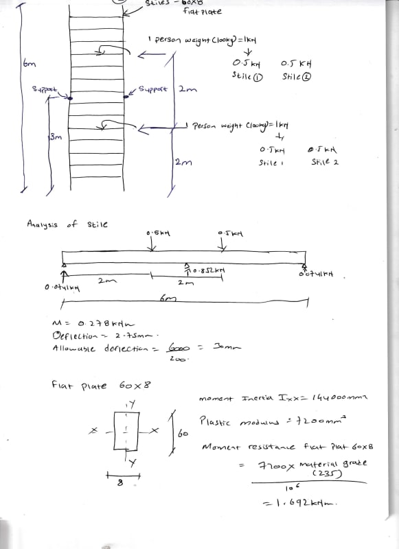

[URL unfurl="true"]https://res.cloudinary.com/engineering-com/image/upload/v1658321394/tips/IMG_20220720_0001_ixcvui.pdf[/url]Hi
Can i have some advice on design of ladder stiles.
thanks

The arrow shows what i am designing in the ladder

I'm not familiar with the ANSI A14.3 - what's the purpose of the (2) 250 pound loads on adjacent rungs? Are those loads vertical only, or are they a moment couple?
I'm not sure... just to provide an extreme overloading? You would think the agencies could put their minds together and come up with a uniform loading requirement.
On the original diagram, it looks like you're checking moment in the ladder without considering the intermediate supports.
Required ladder load and safety factor will vary depending on the applicable codes- may be from OSHA, ASCE 7, etc.
I assume the two loads represent two climbers spaced out.
I could buy the (2) 250 lb loads as 2 climbers if they were spaced even 2 rungs apart, but dik's notes say that those are on adjacent rungs. Not saying that it couldn't be 2 climbers, but you'd really have to work at it to stack up like that.
I've been designing them wrong for years... A14.3 states:
It doesn't cause a problem because the loading doesn't impact the rungs or the side rails... but program fixed and notes revised... thanks.
Note Revised to... "1.2 1.1KN (250LB) AT ANY LOCATION ON ANY TWO ADJACENT A RUNGS IN ACCORD WITH ANSI A14.3;" I cannot edit the original posting.
I would interpret that note a little differently. Attachments are not rungs. See below.
Also, 1.2kN is 270LB, not 250.
BA
BART... I think you're correct and have adjusted my notes and program to suit. and load was changed to 1.1kN... thanks.
