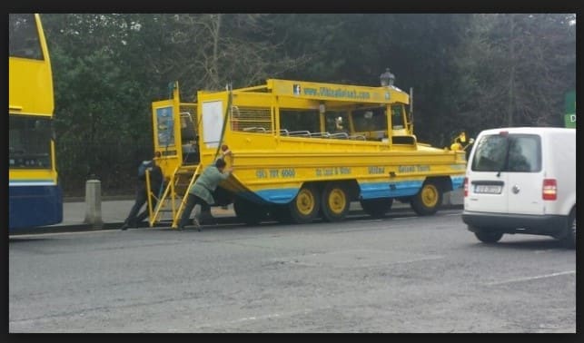

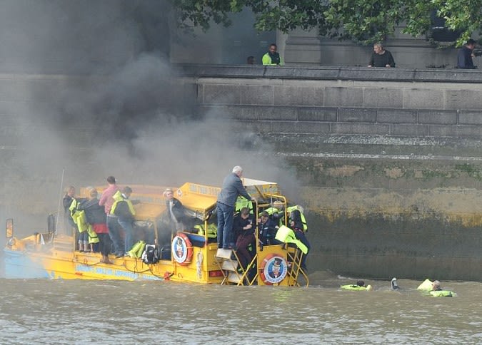

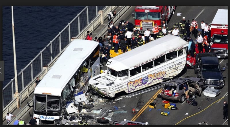

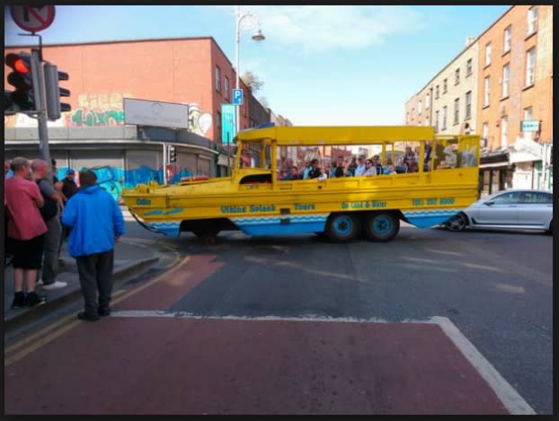

It is not necessary to sink to lose your life in a DUKW. Lack of proper maintenance by the organizations that operate the DUKW's caused the incidents/accidents and/or fatalities in the following examples.
It would have been nice to include some additional details, like where and when these incidents occurred.

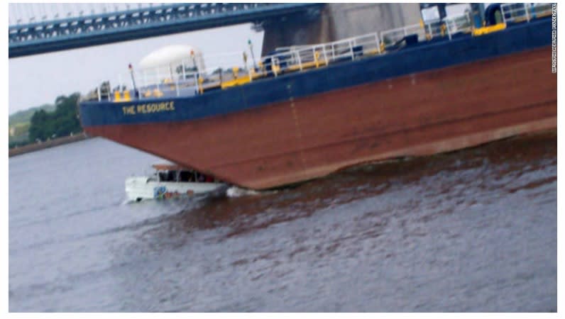

Don't worry about details, like the fact that the barge picture was found to be the tug captains fault after ignoring radio calls. I don't believe anyone died in that incident either.
You want some details:
"On July 7, 2010, a barge pushed by a tugboat struck a duck boat stranded in the Delaware River off Penn’s Landing after an engine fire.
Once struck, the amphibious craft capsized and two Hungarian tourists drowned.
The tugboat’s pilot, the Inquirer reported, was on his cellphone handling a family emergency. He served a one-year sentence for “the maritime equivalent of involuntary manslaughter.”"
In October 2016, the company announced it would “indefinitely” suspend operations in Philadelphia due, in part, to a 330 percent increase in insurance premiums, the Philadelphia Inquirer reported.
The boat was adrift and the passengers were all doing fine until the pilot of the tug ran it over with the barge. Just because a boat breaks down doesn't mean it's fair game to be run over.
Agree it is not fair game to be run over, but the Delaware River is the fifth largest port complex in the United States. The river is tidal and the current may be swift. Not a good place to be adrift.
Saying that having engine issues and drifting is the cause of those deaths is about the same as saying that a failed tire would be at fault for deaths if a bus pulls over to the side of a road for a flat and then gets run over by a transport truck. Both of those issues would lead up to the final incident, but the actual fault lies fully with the operator of the other vessel/vehicle.
