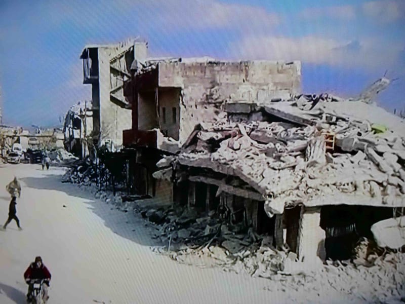

This building on the right caught my eye on a news story about slow delivery of aid to Syria. A lot of the buildings look like soft story failure at the base, but in this particular building, the platform base held up despite the failure of the upper stories.

Turkish engineer Pelin Giritliogu said that in the southern earthquake zone alone, there were over 75,000 buildings that had availed the construction amnesties. Once the rescue efforts wind down, investigations will reveal how many of these buildings actually survived, as compared with the few buildings that were built according to code. One example of such a building was found in the city of Kahraman­maras, where the sole building left erect was the Chamber of Civil Engi­neers, standing tall amid a devastated city.
