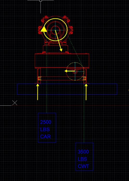

Here is a typical block up elevator machine arrangement with car and counterweight. The car is supported by cables that run over the driving machine sheave, onto a deflector sheave (frictionless) and then down to the counterweight. I am trying to find the most accurate way to analyze the reaction forces at the base of the block up assembly (red) acting on the supporting beam (blue). Obviously the car and counterweight cause tension in the cables that travel over both sheaves - where should this tension be applied? A coworker says I can simply idealize the cable tension as a point load directly on the blue beam at the locations they pass the supporting beam.
My instinct says this isnt the proper way to analyze this. I think I need to start by figuring out the reaction forces of the machine and deflector sheave onto the red beam they are both mounted to. However, I run into the problem that the cable tension is unequal from the car side to the counterweight side. I believe the cable tension on either side of the deflector sheave is equal, but the angle of the rope causes a force downward and towards the drive sheave on the deflector. How should I be analyzing the drive sheave? Am I overthinking this?

The reactions at each mounting foot are the sums of the moments about the opposite foot divided by the distance to the other foot.
That includes the loads from the cables and the weight of the motor/gearbox and the weight of the frame.
The other forces are internal forces and don't affect the load on the beam.
Isn't this like a first year statics problem that can be solved with a simple FBD, or am I missing something here?
This is a free body diagram of the red thing, cables included. Red thing has forces 1, 2, and 5 acting on it (weight), and there are reactions forces and moments where the red thing contacts the rest of the world (blue beam) at 3 and 4 (I generalized in my sketch. Some of these are equal to 0).
Write your equilibrium equations and solve for the unknowns.

"A coworker says I can simply idealize the cable tension as a point load directly on the blue beam at the locations they pass the supporting beam."
This is wrong, and it'll result in a relatively large amount of error in the reaction moments at the feet of the red structure. Whether that error makes the design more or less conservative is an unknown- you'd have to do the math on both scenarios to know, which to me means you might as well just do the math on the accurate version.
If you're modeling the pulley on the right as frictionless, with no brake, and the structure and beam as infinitely stiff, these are the only real forces applied to the red structure:
You need to resolve the vertical component of that force vector which passes through the center of the motor sheave, the moment applied to the motor sheave, and the normal force due to the weight of the red structure in order to arrive at the reactions at the beam.
won't the two loads you show (from the motor sheave and the other lateral force) sum to the two weights (the load and the counter weight) at their lines of action ?
so the external loads on the red are the weights and the motor torque ?
or is the motor torque (added by me !?) a red herring ? the motor torque is reacted by the couple between the load applied to the cable and the reaction applied to the red body ?
and then not an external load ...

I'm thinking the original co-worker is correct, you only need to consider the external loads to determine the loads from the red to the blue (and from teh blue to the "rest of the world"). I think motor torque is a red herring, as the motor applies load to the cable and reactions to this load to the red body.

Those loads don't just disappear - they have to make it down to the feet to be resolved.
In practical terms, the loads don't create a moment sufficient for overturning (ie, the bolts holding the red feet to the blue beam are never going to see tension) but the motor torque does affect the magnitude of the two reactions. In either a dynamic or static analysis of this system the motor torque cannot be ignored. We don't know the size of the motor spool - but if it's a 24" spool (a common-ish size for elevator gear) that is a 1000 ft/lb load at rest with the car not loaded. That's significant.
that was my initial line of thought ... the motor must be applying some load to the cable, to keep it in balance, so we know the torque of the motor (1000 lbs x the sheave radius). But then I thought, wait on, the motor is applying an opposite torque to the red body (where the motor is attached) so now I think the motor doesn't affect the red/blue interface loads. But I'm willing to be wrong ... as I said, the last time I had to think about something like this was uni ... literally a lifetime ago !

It's different because the forces are not truly applied at the locations where the cables hang next to the beam- they are applied through the centerline of the shaft on which the pulleys live. That changes the values of the moments.
As I said earlier - to know which scenario is the more conservative, you would need resolve all forces and calculate reactions for both. If you're going to do that, you might as well save time and just calculate the one that's right.
