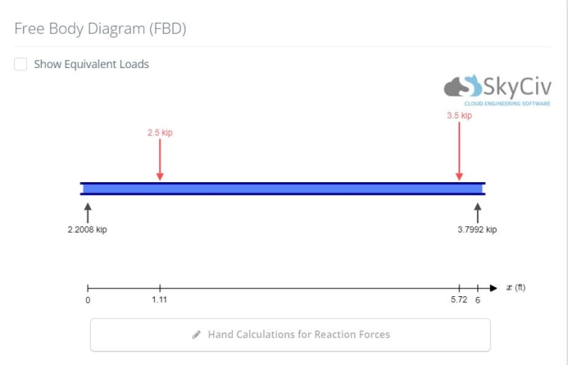

Here is a typical block up elevator machine arrangement with car and counterweight. The car is supported by cables that run over the driving machine sheave, onto a deflector sheave (frictionless) and then down to the counterweight. I am trying to find the most accurate way to analyze the reaction forces at the base of the block up assembly (red) acting on the supporting beam (blue). Obviously the car and counterweight cause tension in the cables that travel over both sheaves - where should this tension be applied? A coworker says I can simply idealize the cable tension as a point load directly on the blue beam at the locations they pass the supporting beam.
My instinct says this isnt the proper way to analyze this. I think I need to start by figuring out the reaction forces of the machine and deflector sheave onto the red beam they are both mounted to. However, I run into the problem that the cable tension is unequal from the car side to the counterweight side. I believe the cable tension on either side of the deflector sheave is equal, but the angle of the rope causes a force downward and towards the drive sheave on the deflector. How should I be analyzing the drive sheave? Am I overthinking this?

Assuming this (static car), I would calc the interface loads red/blue and blue/"rest of the world" from the two loads shown, as suggested by co-worker. I think everything within the red body is "irrelevant" to the overall load balance.

If I take moments about the red feet I will get the reactions at the red feet, you can take moments about any point in a structure.

Right... but if the vertical loads move relative to the feet, the moments change. The vertical loads are not applied at the point where the wire rope hangs next to the beam; they are applied at the shaft on which the sheave lives. That changes the distance and thus the moment applied by each force, and it's also why you can't ignore the torque applied by the brake which is holding this whole system in a static position.
if the loads move vertically, (ie start at height H1, move then static at height H2) then no change to external reactions.
there would be a change during motion, when the weights accelerate.
I'm not talking vertically. I'm talking horizontally - ie the distance between where the load is applied and where the reaction force is applied by the beam, in the x axis.
The loads from anything hanging from those cables are not applied at the location where the cable crosses the beam. They are applied to the shaft carrying the sheave.
well then, yes. the "load" as I speak of it is the load vector, magnitude and location.
"The loads from anything hanging from those cables are not applied at the location where the cable crosses the beam. They are applied to the shaft carrying the sheave." ... um, sorry I disagree. The load's line of action determines the external reactions, not how the load interfaces with the innards of the red body.

But the line of action is through the center of the shaft.
You're saying that this arrangement of forces, which represents the real world:
Is accurately modeled by this arrangement of forces:
That just isn't true. Sorry. The reactions aren't even close.
3.5*(5.72-2.21)+2.5*(1.11-2.21) = 12.285-2.75 = 9.535 .NE. 1 ... the scenarios "aren't even close".
apply 3.5 load at 3.28 for a net moment of 1

Uhhh... yeah. Exactly. The 1 kip/ft moment is the actual load applied to the red frame by the brake torque holding the loads in place (assuming a 24" traction sheave diameter... which I did). The imaginary moment you calculated above has nothing to do with anything.
@swinnyGG ... your two loading examples are not the same, so their reactions are not the same.
I think the correct loading is scenario 2. You can think otherwise, it's a free world.
The line of action of the loads is not through the sheave, but is along the weight vectors (since the load is weight).
I think scenario 1 should include the load at the idler ... the loads on these two (the main load on the sheave and a secondary load on the idler) should be (must be) equivalent to the weights applied. This is not a choice. The loading in scenario 1, as rational as it appears, is not equivalent to the applied weights.

OP stated in his original problem statement that he's considering the deflector sheave as frictionless; by convention in machine design, frictionless sheaves can only apply loads normal to and in line with their shafts. In this case that means the vertical load which would exist on that sheave in the real world is replaced with a zero. The horizontal load applied to that sheave is resolved internally in the red structure; the only remaining vertical force is the load through the shaft of the traction sheave.

If there was a black box around the structure, and all you saw were the two weights (and the ropes attaching them to the black box) and the blue beam protruding beyond the black box (supporting the structure to "the rest of the world), how would you calculate the reactions at the end of the blue beam ? Two applied forces, two reactions ... simple.
Then look inside the black box. Each time you simplify the load, say remove the cable and have the loads applied at the pully centers, then your loading must be exactly equivalent to the earlier loads ... same direct load, same moment about the same point. By moving the direct load to the sheave you are ignoring the load on the idler, which is mostly horizontal so the load at the sheave also has a horizontal component (small though it may be) and here is the couple (moment) you've lost.
