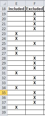

I am looking for a way to enter an 'X' in a cell when double clicked. The cell next to it should then be clear. See example below.
If I click on cell 'E20', then I want an 'X' to appear, and cell 'F20' is blank, and vice versa.
Thank you.

I had to make some modifications to get it to work. I also added Cancel = True at the end because it was causing some issues.
This version is tested and working for cells E19 to F39

Thank you for your help. This worked great. I just have one change.
There are actually two sections that need this. The original as shown, and also E/F74 - E/F106. Is it possible to do two sections?
Thank you.
Sure, here you go. You can make as many ranges as you need. Just follow the same pattern.
