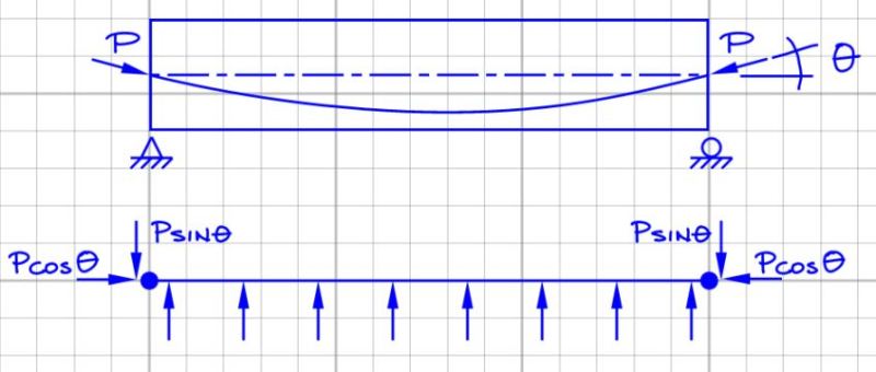

When I think of unbonded PT, the sketch below pops into my head verbatim.
M_external_load - M_balancing < M_ultimate
OR
M_external_load < M_ultimate + M_balancing

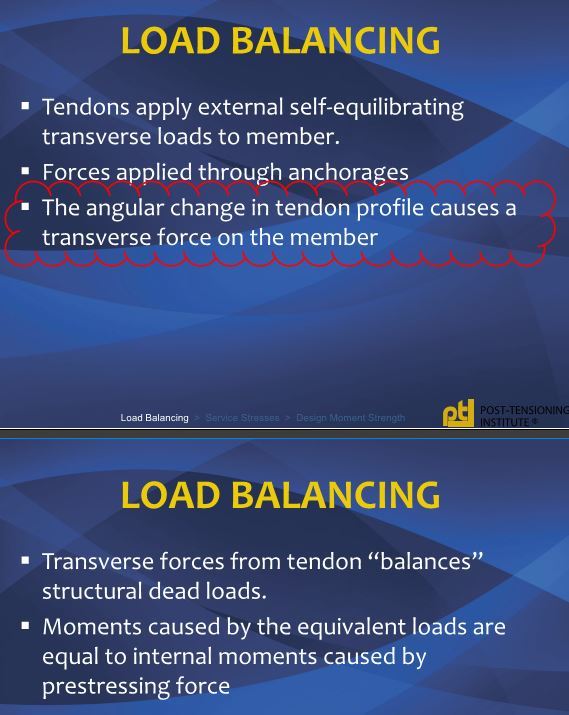

P.e is not the load balancing effect. The load balancing effect is a result of the angular change in tendon profile (Your Msec?)

I'm not treating P.e a part of the applied load rapt. I'm treating the effect of tendon angular change as part of the applied load as discussed in that PTI document that we've been passing around and as illustrated in the sketch that I posted with my last comment.

Checks, checks, checks... The simple fact of the matter is that tendon drape helps to resist load. Whether that assistance is conceptualized as an external action reducing demand, or as an internal action increasing capacity, is simply a matter of choice and convenience. Since most designers are interested in the ability to carry load external to the concrete, I find it convenient to take the view that tendon drape increases capacity.
Here's a question for you: if tendon drape does not improve a pre-stressed member's ability to resist load, then why do we bother with it?
A prestressing strand in a pretensioned member, with the strand flat, provides the same ultimate capacity as a draped strand of the same size and with the same effective depth.

It has nothing to do with bonded/unbonded prestress. The only difference with unbonded is that there is no strain/compatibility between the prestressing steel and the concrete surrounding it, so everyone tries to guess the stress in the unbonded steel at ultimate as it is not directly related to the strain in the concrete.
To look at the simplest case of a simply supported span (just to take continuity effects out of it), to balance a load of w, the moment at mid span from the load balancing would be
mp = wl^2 / 8
The prestress force to balance this is mp / e = P
so P = wl^2 / 8 e
or P e = wl^2/8
So the moment effect of load balancing = P.e
This is true at any point in ant determinate member. In indeterminate members, secondary moment effects change this but the overall logic is still the same. In indeterminate members, the secondary moment effect is considered to be an external action, while the P e (balancing effect) is considered to be part of the capacity.
I sincerely hope you have not designed any PT members by this methodology as they will be under capacity by P e, so could be reaching their true ultimate capacity at or below the service moment.
First a comment on Load balancing
If you look at the Leonhardt (No he was not Australian) bible on PT, written well before TY Lin discussed load balancing, he was talking about Equivalent Moments from prestress and relating them to the Moment diagram in a span. He was basically talking about Moment Balancing, later popularized by Lin into Load Balancing. Problem with Load Balancing is that the logic only works easily in simple cases and where there is no change in the prestress force in a span. Moment Balancing is much easier to work with and it is related to P.e at every point in the span. For a parabolic tendon that comes out to a balanced load over the length of the parabola. Whew you start adding reverse curves in your tendons, straight lengths, harped profiles and transmission lengths in pre-tensioned strands and post tensioned dead ends, then load balancing is near impossible to work with.

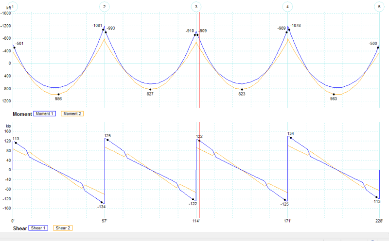

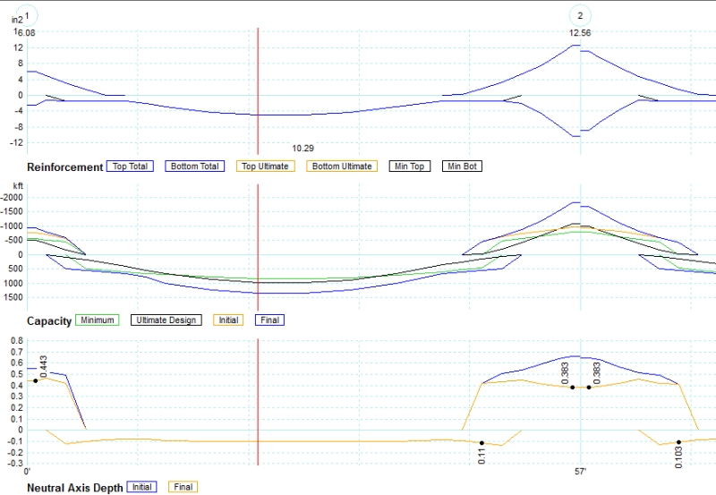

1. With the pan joist spacing of 6' c/c, the prestress is balancing about 70% of DL to interior spans, but less in end spans.
2. Based upon a quick check I ran, you require significant more flexural reinf, as you indicated. Calcs based up 14x0.5" UNbonded strands, or 350 kips.
3. There are ductility problems in negative moments regions adjacent to interior columns, requiring compression reinf.

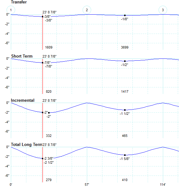

4. Long-term delfections are up there.
Factored Moment and Shear: (all spans loaded, no LL reduction):
Mild Steel reinf required, for end span:
Deflection estimates:

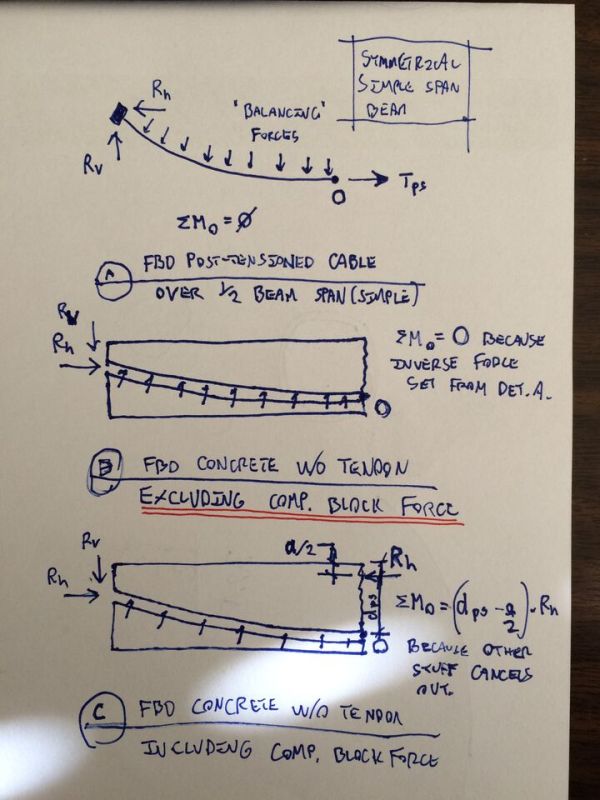

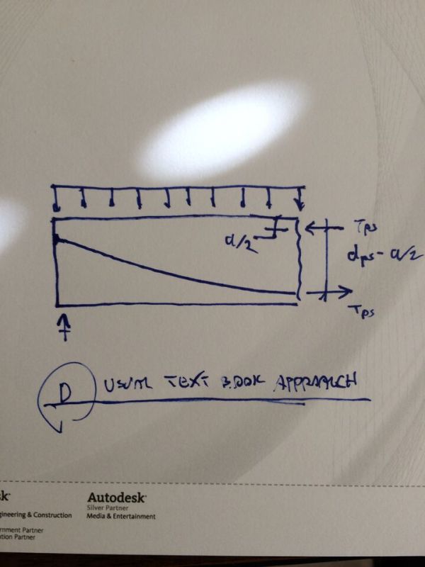

Diagrams similar to this pop up frequently in derivations of the ultimate moment capacity of PT beams. That's probably because it's the simplest presentation. The limits of the free body diagram are defined such that they include the concrete and the PT tendon. I agree that it's correct and statically equivalent to other formulations but, unfortunately, I just don't feel it. In particular, for unbonded tendons, it bothers me that the Tps force is shown at a location where it isn't actually acting on the concrete. My rational brain gets it but, again, I just don't feel it. Instead, I'm going to study the concrete and PT tendon separately.
In detail A below, I've examined the equilibrium of the cable independently of everything else. I've ignored complicating phenomena like friction, wobble, relaxation etc. By definition, moments taken about point O sum to zero. The thing stays put.
In detail B below, I've examined the equilibrium of the concrete without the PT tendon and, importantly, without the compression block reaction at the section cut. Because the forces that the tendon impose on the concrete are the inverse of those imposed by the concrete on the tendon, I again take the moment summation about point O to be zero. I propose this as non-rigorous proof (to myself) that balancing forces and anchorage reactions form a self-equibrilating system that, taken in concert, do nothing to improve bending capacity. I also offer this as one explanation for the following statement made by hokie:
In detail C, I again study the concrete on its own, this time with the compression block reaction included. I come up with the usual ultimate moment capacity formulation. This is the part that I have trouble feeling with the usual presentation (my previous post). Looked at in isolation for an unbonded system, there's no tendon tension force on the concrete at point O.
