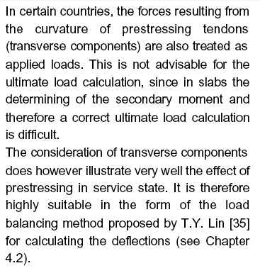

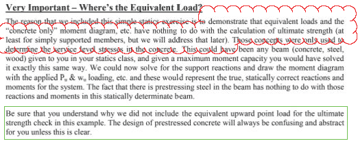

KootK said:
However, I still find statements to the effect of "balancing loads have nothing to do with ultimate flexural capacity" to be rather misleading.
KootK,
It is not just me stating this, Bondy and Allred state it explicitly on page 72 of their 2nd edition PT book "Post-Tensioned Concrete - Principles and Practice":
I know. Similar statements pervade the literature. It wasn't my intention to single yours out.

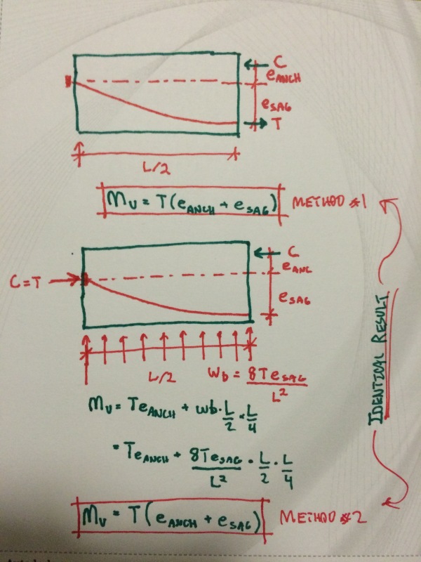

This sounds as though you may be agreeing with one of my recent assertions, namely that an alternate formulation of ultimate moment capacity could be developed using balancing load effects. If I'm out to lunch here, please don't be offended by my suggesting that you might agree with me.
Sometimes I wonder if it appears as though I'm trying to lay claim to something more radical than I actually am. In an effort to clarify, please see the sketches below where I have derived the ultimate moment capacity of a simple plan post-tensioned beam:
a) Using the traditional approach.
b) Using the balanced load effect.
The algebra comes out in the wash and, as expected, the results are the same. Did I make a bunch of simplifying assumptions? You bet. And if you feel that any of those simplifying assumptions invalidates the core work, feel free to jump up and down while waving your arms furiously.
Here is a list of what I believe the takeaways are and are not:
1) Once could calculate Mu using the balancing load effect rather than the traditional method.
2) I am NOT suggesting that this is a better way to calculate Mu. It's a worse way computationally.
3) If one removed the balancing load effect from the second formulation below, the ultimate moment capacity would obviously be reduced. Since methods one and two are statically equivalent, the same is true for method one. Thus, balancing load effects play a role in ultimate moment capacity.
4) In the usual formulation, we don't get to apply T at (e_anch + e_sag) from C because that's where the tendon is. We get to apply T there because that's the location that the balancing load effect has shifted the center of precompresson to. It's just math/physics fun that the center of precompression is always located at the tendon height. I derived this aspect of things with details A&B above.
That's it. That's the entirety of my argument here.
KootK said:
IDS said:
Let's make it even closer to an unbonded p-t beam by moving the cables down at the ends so they intersect at the concrete centroid, then anchor the cables to the concrete with a loss-free anchoring system. The forces in the cable are now the same, and the concrete is the same except it now has a uniform compressive stress.
I'm not clear with regard to what has been retained of the GGB analogy? This mostly sounds like an ordinary PT beam to me. Can you elaborate?
What I have retained is everything except the cable is now anchored to the concrete, rather than an external point. The forces in the cable are exactly as before, and the bending and shear stresses in the concrete are exactly as before, i.e. zero. The only thing that has changed is that the concrete now has a uniform compression. The fact that the beam is now an ordinary PT beam is the point. The other point is that the stress distribution at mid-span is exactly the same as for a bonded post-tensioned system with the same cable profile, or a straight profile.

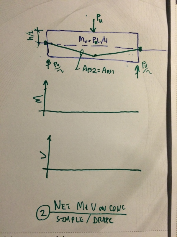

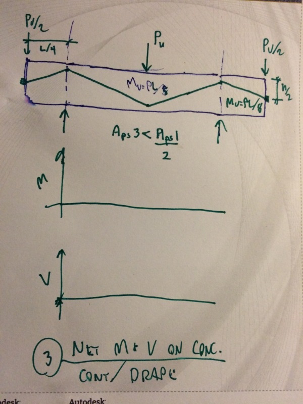

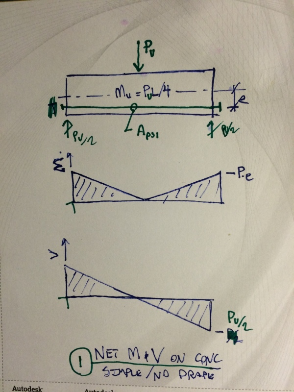

hokie66 said:
Whether it is draped or not does not affect the ultimate flexural strength.
hokie66 said:
The reason draped strand structures have greater capacity is because they are continuous. That is one answer to your question about why we do it.
I've been wanting to circle back to these statements. I initially found the first shocking and the second somewhat confusing. Having had some time to ruminate on this stuff, however, I think that I have some new insights that I'd like to have vetted.
First, a little background. On my first PT project, my mentor gave me his spiel about how tendon drape essentially allowed one to move load from the point of application out to the supporting columns without really involving the concrete. I thought it was super cool. And I still do. So when I found out that drape doesn't improve ultimate bending capacity, I was peeved.
Here's what I've come up with since:
1) Given a particular tendon elevation, drape does not improve cross section ultimate moment capacity. It may, however, improve member/structure ultimate load carrying capacity. This was probably what you intended all along with respect to the two statements quoted above.
2) In detail #1 below, I've considered a simple span beam in which the tendons are set out flat. In detail #2, I've considered the same beam with harped tendons. In a sense, one could say that even this member is improved by tendon drape as the draped arrangement reduces the flexural demand on the concrete at all sections other than midspan.
3) In detail #3, I've considered a continuous beam in which the tendons are draped to more optimal effect. In truly continuous members, one is afforded the opportunity to maximize tendon sag while still keeping anchorage forces located at the section centroid. This would seem to be an improvement over the simple span beam scenario.
4) To some extent, even simple span pre-stressed concrete members can exhibit features of continuity. This is because such members are effectively able to have applied end moments as a result of the pre-stress anchorage forces.
