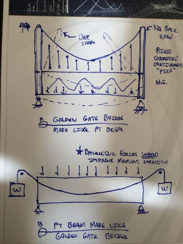

Yes. Previously, I mentioned the example of the Golden Gate bridge. I thought that a salient example at the time. In order to get my world view fully adjusted, I feel it necessary to answer my own questions regarding that example. What was missing there, I think, was
a) a proper appreciation of the self-equilibrating nature of Pe & Balancing loads and;
b) Recognition that the PT anchorage situation is markedly different for the golden gate bridge.
To clarify, I've sketched up:
a) A fictional version of the Golden Gate that is more like a PT beam, where drape doesn't matter and;
b) A fictional version of a PT beam that is more like the Golden gate bride, where drape matters.

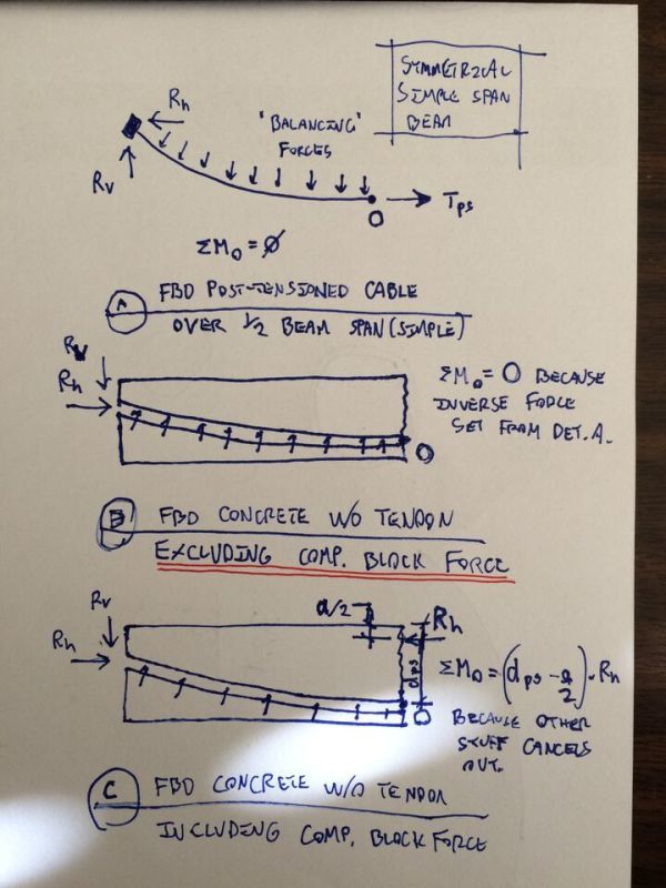

Per the sketch that I posted above, and have repeated below, I believe that the balanced load effects are implicitly built into our procedure for ultimate moment capacity. If you removed the load balancing effects, ultimate bending capacity would need to be reduced as a as result.
Logically, if concrete crushing meant that we could no longer rely on the tension in the tendon, all that we'd be left with for moment capacity would be the portion attributed to the non-prestressed reinforcement. And that certainly isn't reflected in our procedure for determining ultimate flexural capacity.
KootK said:
Per the sketch that I posted above, and have repeated below, I believe that the balanced load effects are implicitly built into our procedure for ultimate moment capacity. If you removed the load balancing effects, ultimate bending capacity would need to be reduced as a result.
If the tendons are flat, i.e. without drape, at the same effective depth as you show at midspan, the prestress force would then be applying an equal and opposite moment at each end of the member, namely P.e which would cause an upward deflection of PeL/8EI; if you call that load balancing, then the load it is balancing is a uniform moment across the span without external reactions, not a gravity load balancing.
If the tendons are flat at the neutral axis, there would be no balancing of any kind but the ultimate moment capacity would still be the ultimate tendon force times the depth to the middle of the stress block.
BA
@BA: I would consider the flat tendon scenario to be a unique, and obviously somewhat trivial, case of load balancing where the equivalent balanced load is zero. That said, I still believe that the derivation that I posted above would apply as follows:
1) With no tendon curvature, the transverse balancing load effect would be non-existent and thus it would create no moment about point O.
2) The horizontal anchorage force would also create no moment about point O because the anchorage and point O would be vertically aligned.
3) The vertical anchorage force would be zero and thus also create no moment about point O.
4) All summed, we again have a self-equilibrated M=0 system in which the net effect of the balanced load forces and anchorage forces on ultimate moment is no effect at all. And, if that's correct, it would be great as a universally applicable principle is the most confidence inspiring kind in my opinion.

The procedure for determining ultimate moment capacity in a prestressed member is identical to that of a conventionally reinforced member and has nothing to do with balanced load effects.
The procedure does not involve balanced load effects but that's only because they cancel out. The mechanism by which ultimate loads are resisted does involve balanced load effects, however, per my derivation.
BA said:
Why would ultimate bending capacity need to be reduced if the load balancing effects were removed?
To see the effect, take my detail C above and remove the balanced load effect. To maintain equilibrium, the moment resistance would decrease by the amount that the balanced load effect previously contributed to the system.
BAretired said:
Can you provide an example of that?
No, because it's not possible. That was the 'proof' that I proposed with details A and B. The balancing effects and anchorage forces form a self-equilibrating system that has no net effect on ultimate moment capacity. I'm not suggesting that we need to change our method for calculating ultimate flexural capacity. I'm simply clarifying that a) our procedure assumes that balancing forces are alive and kicking in the ultimate condition b) load balancing forces are in fact alive and kicking in the ultimate condition.
