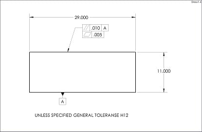

Could you provide an example within which the additional geometrical tolerance is considered as refinement and does not nullify the general unless othwerwise specified?
I am not Chez, but I will try:
Parallelism is a refinement of size, flatness is a refinement of parallelism, but Envelope rule still in full effect.
(11h12 = 11 +.000/-.020)
