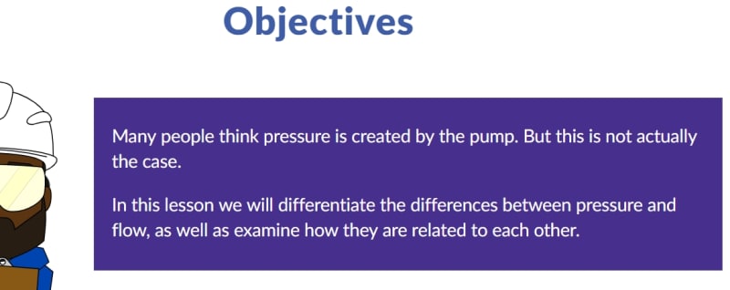

For a hydraulic guy to say that pressure is created by resistance to flow is like an electrician would say that the resistor creates the voltage...Right!?[ponder][bigglasses]
Listen to
Jim Pytel, Columbia Gorge Community College
in his Youtube lesson
LunchBoxSession
Insane Hydraulics
"For a hydraulic guy to say that pressure is created by resistance to flow is like an electrician would say that the resistor creates the voltage...Right!?"
No, the corresponding analogy would be "voltage is created by the resistance to current flow" More properly, though, it's voltage DROP that is created by resistance to current flow.

I can't understand how people high up in the recognized fluid power hierocracy (see the 3 examples in my opening post) can say that pressure comes from the resistance to flow.
