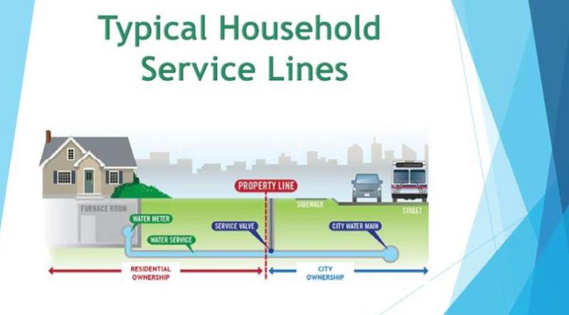

3) Someone has already covered this, but the source of lead contamination is not the Flint river water, or the city mains- it is the drops that connect the mains to individual buildings and homes. Some of the children who have suffered extreme lead exposure live on the same block as other children whose blood tests resulted in zero lead found. This is obviously a huge problem, and in no way am I attempting to downplay that, but it is a huge problem that has to be diagnosed on a case-by-case basis- it is not nearly as simple as the media is depicting it to be.
Well said jgKRI. it is the drops that connect the mains to individual buildings and homes.
These drops were there a long time ago.
Could a charcoal filter on each of these homes (<$200/home) stop the problem?

Yes, you could install devices in homes. However, what happens frequently is that the devices are not properly maintained by the homeowners, so this remedy is not the preferred approach to solving these types of problems.
