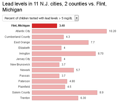

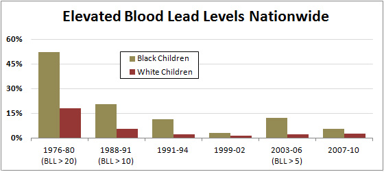

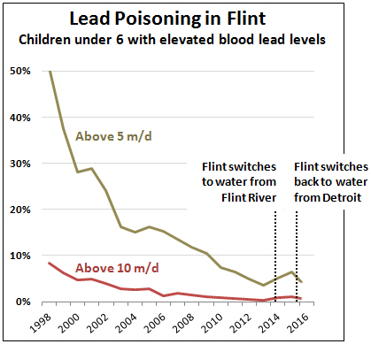

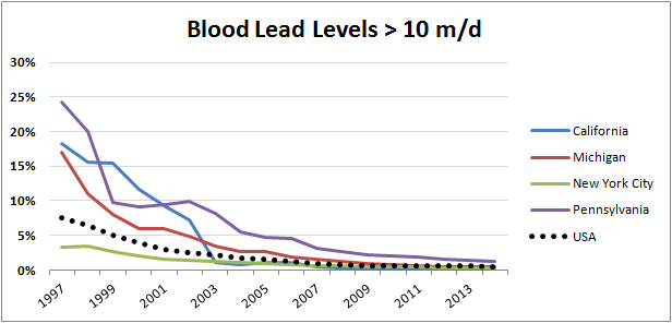

I've been looking for some time for real information as to the blood lead levels resulting from this fiasco. Overwhelmingly, news stories provide no actual information in this regard.
The best information I've found has come from Kevin Drum of Mother Jones magazine (a solidly left-wing poltical magazine, for those of you unfamiliar with it). He has written extensively for years on the horrible effects of elevated blood lead levels in the mid 20th Century.
His conclusion on this: "Flint is not a public health holocaust."
Some key graphs from his recent reports that put things in perspective:
Those of us middle aged and older, who grew up in the age of leaded gasoline, almost certainly had higher blood lead levels that the worst affected of the Flint children.
