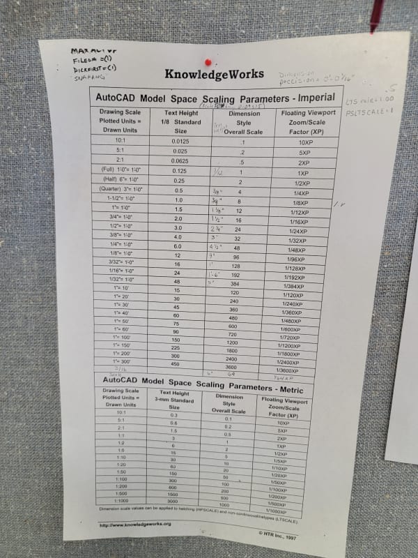

Just found this old sheet given to me when I first started working.
That's funny Jerseyshore. I see the notes with pencil on top right. When something is not printing right, us engineers (not knowing CAD that much) always do the following:
PSLTSCALE: 1 or 0 (have no idea which one is right), then we type REGEN
LTSCALE: 1 or 0, REGEN
MSLTSCALE maybe? REGEN
If it still looks funky, then we ask for help LOL.

Yeah that sheet was dated 1997 which was when I was in elementary school so I didn't even know AutoCad existed and obviously whoever gave me this page had some troubles with it too.
Right next to this sheet on my wall is a list of about 50 of the most commonly used AutoCad shortcuts that I put together so that the other engineers would stop asking me how to move something or draw a rectangle.
