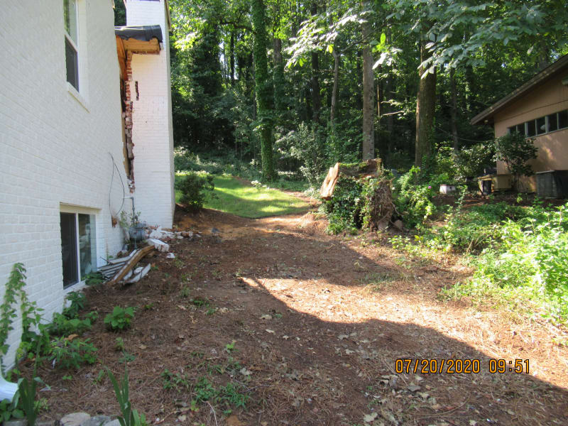

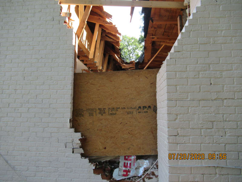

Below are 2 pictures someone sent me showing baseball bat tree damage. You can see the tree is not far from the house in the first picture.
As others noted, your later post about new concrete cracks provide more proof it could be from the tree. In the pictures below, one of the exterior walls tried to move outwards at the bottom due to the tree. The wall did kick out at the base. This is not a slab house, but if it was and had the wall been anchor bolted better, I could easily see it causing a tension crack in a slab. The crack could be close to the wall or far away. Depends on the slab stresses. To me the slab is a brittle component since I will bet that any WWF is against the ground. Brittle components that are about to fail tend to look just like brittle components in good condition.
