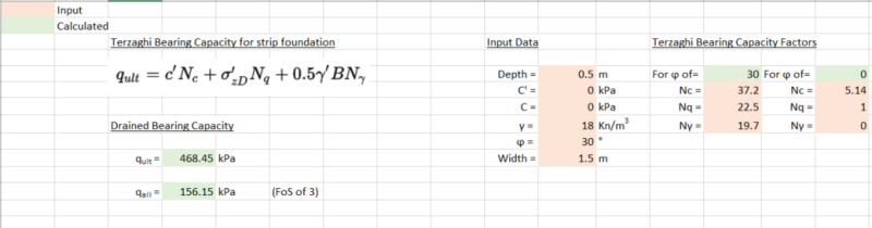

I think you have a bearing capacity problem. In your spreadsheet and drawing you has assumed (or calculated?) a bearing resistance of 250kPak, is this an ultimate or allowable?. I dont think a base soil with Phi' of 28 degrees will give you that. Your drawings done indicate if you are intending to bury your base or sit it on ground level? If you are not burying your base it reduces your available bearing capacity.
I did a quick and dirty check using Terzaghi's equation and for the Phi above, assuming 1.5m breadth by 1m width, you have an allowable bearing resistance of 156kPa. See below.

Very good suggestion thanks a lot, you are absolutely correct, I need that 100mmm distance otherwise where would i support the formwork?
About battering the wall into the soil, again thats a good approach because at some point in the future you might get some rotation especially during an earthquake. i will have to talk about this with the formwork contractor and see what he says, how expensive or difficult this might be?

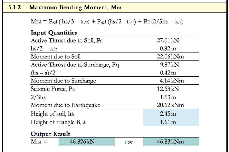

Now i am designing the vertical reinforcement for the stem of the wall.
1. the maximum bending moment i get at the bottom of the wall were it connects with the foundations is as shown below

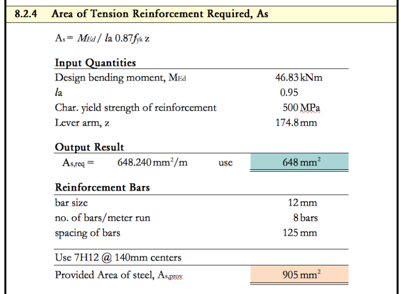

2. I then design the reinforcement required according to above bending moment
This is for the tension side of the wall, common practise suggests that the same amount of reinforcement is used on the compression
side as well, however i am skeptical about that. Is the steel on the compression side of the wall actually work?
can i save some steel by using 10mm bars on the compressions side instead of 12mm?

To answer your question, technically the compression side does not require it's own layer of steel. I've been keen to omit it when possible to keep congestion to a minimum at the wall to footing connection.
kellez - 12mm bars with 125mm (or even 140mm) spacing? Why so "small" and close together?
For a wall of these proportions, look into saving money (reduced rebar handling/installation cost) by using fewer bars, of a larger size with greater spacing to get the same weight of rebar / meter of wall length. Rebar sizing/spacing is a compromise, don't want individual bars to be so "heavy" that a crane is needed to place them. Also, don't want the spacing to be "too large"... but bar spacing somewhat > 140mm should not be "too large" for this wall.
Agree with jayrod12 about the compression side rebar. The Eurocode (that I am not familiar with) may have guidance on the compression side (or total amount) of rebar required.
