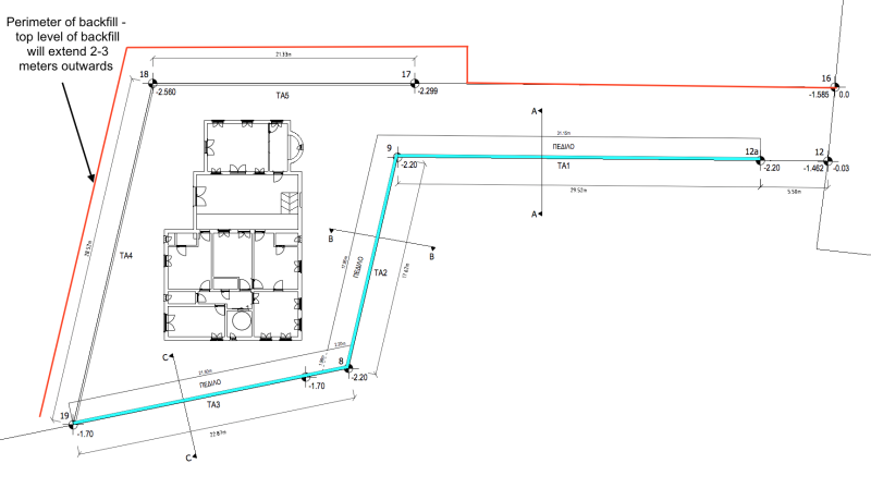

Hello everyone, please find attached a drawing of the retaining wall i am designing according to EC7 together with an excel file of my calculations.
Its a cantilever L-shaped reinforced concrete wall comprised of a stem and foundation slab.
Backfill soil is well graded gravel with unitweight = 20kN/m3 and angle of friction = 25degrees (conservative value)
Wall height is 4.20m, Height of soil retained by wall is 2.70meters.
Surcharge load = 10kPa, A seismic force has also been considered.
According to my calculations my problem here is that the foundation of the wall needs to be at least 1.80meters wide in order to get a safety factor of 0.94 against sliding, which i think its too much for this design.
So for a 2.70m hight soil i get a 1.80m wide foundation slab in order to resist sliding. Dont you guys think that This is a really expensive design? am i doing something wrong? or did i get tit right?

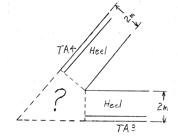

SlideRuleEra said:
You still have to deal with exterior corner design. At the exterior corners stop concrete placement where the wall heels interfere:
the layout of the retaining wall has been changed, wall TA4 and wall TA5 will not be build, instead we will extend
the perimeter of the backfill about 2-3 meters outwards (see drawing below). therefore the exterior corner shown on your drawing above
will not be build.
if you check the latest plan view drawing on my last post (or the drawing below) you will see that the walls TA4 and TA5 are not shown

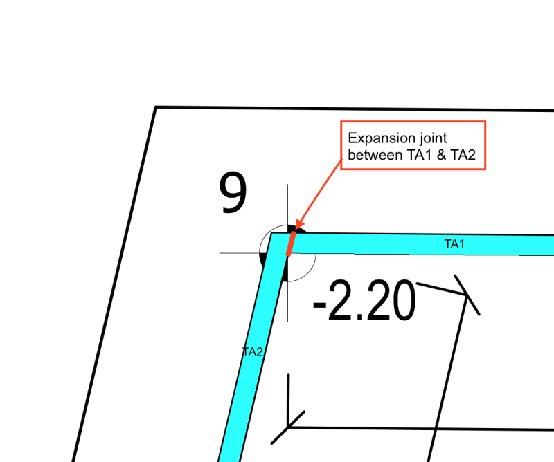

1. I would omit all the concrete in the "interior" corner (see the image below). The wall stem stem thickness and reinforcement are minimal, the wall will deflect under soil loading. I would want each wall to move independent of the other. Fortunately, for this interior corner, the two walls will move closer together. An expansion joint between wall stems should take care of deflection.
Unfortunately the reinforcement and formwork of the footing at the corner shown above has already been build.
However if i add an expansion joint (as you suggested, and as shown on the drawing below) between the stem of walls
TA1 and TA2 so that the walls are independent of each other, wouldnt it still be fine? and accommodate any issues
of interaction between the two walls even if the their footings are connected at the corner?
That's what acetylene torches are for. Cut the rebar and reform... or even better, postpone the concrete placement until you complete the design. Last minute changes like that are commonplace in the heavy construction industry. I would want those two structures to be entirely separate from each other - the reinforcement was designed for one thing, and only one thing - to resist soil loading. Who knows what type loading will be applied to a single slab with two walls, each loaded in a different direction. Don't dwell on what you can't do, as I said earlier, you are in a "mess"... try to get yourself out of it.

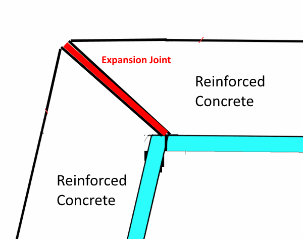

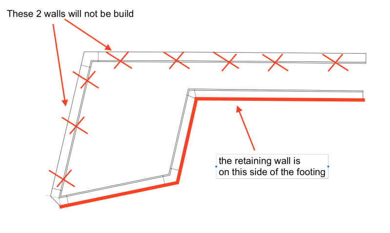

dik said:
Can you provide joints like the attached?
the two walls indicated below in the drawing will not be build.
i think your drawing of the wall and the footings is wrong, the footing should be on the inside of
the retaining wall, therefore you should move the wall in the opposite side of the footing as shown
in the drawing below
1) what type of joints are you referring to? Expansion or contraction joints?
2) where are the joints located? on the wall, footing or both?
Sorry... I thought that was the soil side. You are filling the site to provide a level surface for the home?

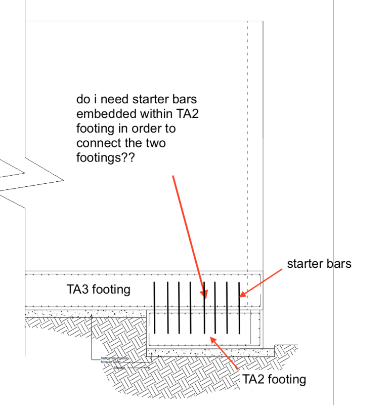

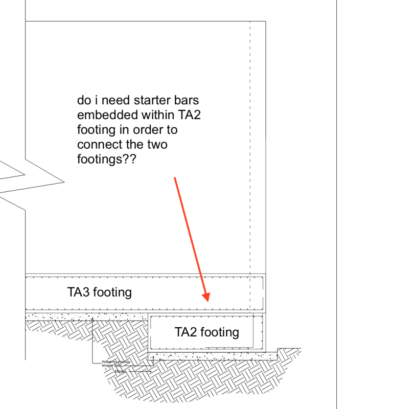

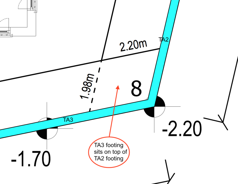

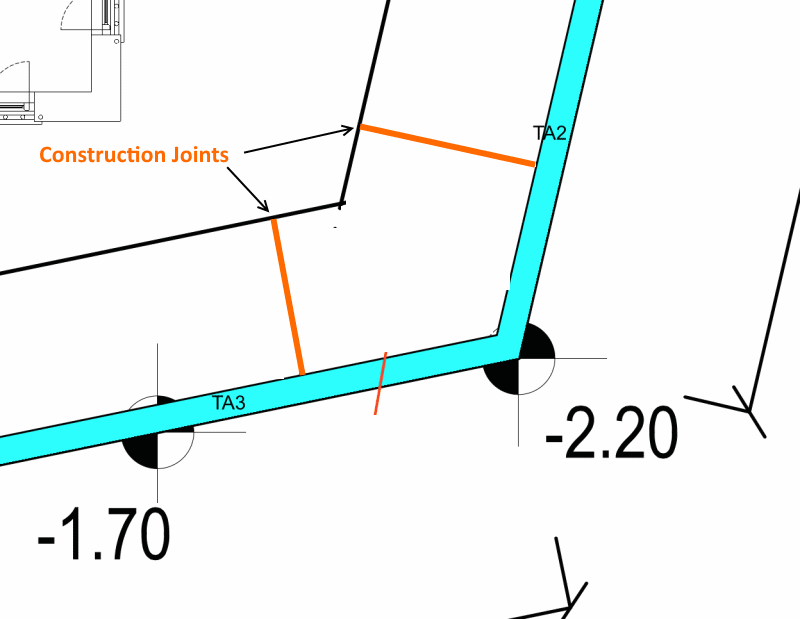

2) *we are not going to pour TA3 footing because it is on a different level than the rest of the footings,
actually part of TA3 footing sits on top of TA2 footing
see drawing below
do i need to connect the two footings together by embedding starter bars inside TA2 footing?

Kellez - Review my earlier posts today. Overlapping slabs get back to the problems with loading that is not addressed in design. Consider that what you show as overlap could be a single slab (of whatever thickness is needed) that supports two short walls. This block will have to be designed for soil pressure, overturning, sliding, etc.
[idea]
[r2d2]
