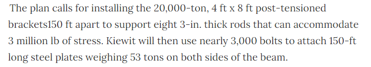

Bill-
I saw it in one of the briefing documents here-Link
Brad Waybright
The more you know, the more you know you don't know.
"...150-ft long steel plates weighing 53 tons..."
Steel weighs about 40 pounds for a 1 foot square an inch thick.
If we assume each steel plate is 4 feet high and one inch thick, then each plate weighs 24,000 pounds--12 tons.
If there is a plate on either side of a beam, and there are two beams, it is looking like the 53 tons is the total for all four pieces.
I will guess the nuts and bolts will add another 3 tons.

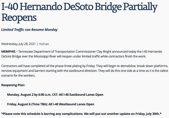

I found the press release regarding added weight:
June 25, 2021
"108,000 pounds of structural steel plating added to the tie girder"
So ya got 54 tons. Not "hundreds of tons". Not "1.7 thousand tons".

From the ENR article, 216 thousand pounds. 108,00lbs plus two other quantities. The ENR website allows one complimentary visit and I can't go back and recheck but I remember adding the quantities up to a total of 216,000 lbs. That is only three 18 wheelers at 72,000 lbs each.
That is a very old weight limit, most semis are heavier than that today.

This is considered a permanent repair, at least as long as frequent periodic inspections don't show anything untoward. Most of the damaged steel was removed and where that wasn't possible additional support and bracing was added.
Additional information here Link
