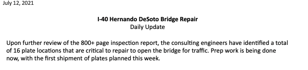

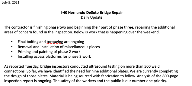

Update: The repairs to the fault are complete, but the ND testing identified 9 other areas that need plating:
Source
Latest update:
Seems like the ND testing found quite a few failed welds that needed repairs.

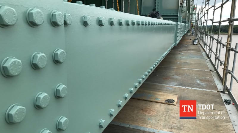

TDOT also published a picture of the 'phase 2' repairs with a fresh coat of paint:

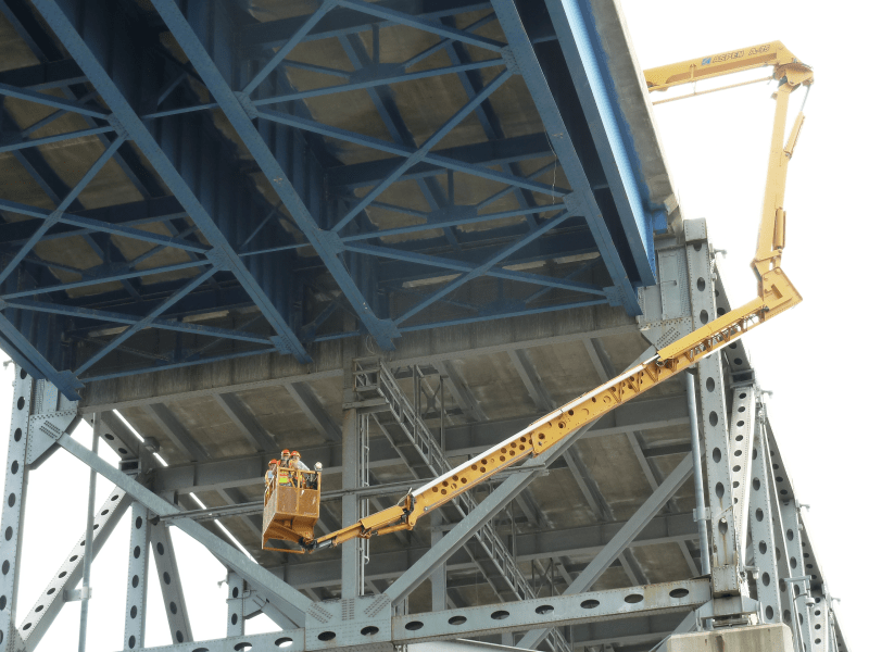

According to him, the fault was not visible from the angle of the snooper truck because it could not go far enough outboard...
Definitely feels like a 'process' failure. I hope they are fixing the process rather than just making this fellow a scapegoat.
I don't buy this:
"According to him, the fault was not visible from the angle of the snooper truck because it could not go far enough outboard..."
The snooper bucket launches from the bridge deck and then articulates outboard on its way for inspectors to access structure under the deck. The bucket is absolutely outboard of the structure far enough to see the crack, even if there is some distance bridge length-wise.
The crack is very visible viewed from above, and from anywhere outboard. Not visible from directly below or inboard.
Heck, this crack was visible in photos taken by kayakers 100' below.
Something else must explain why it was missed... Repeatedly.
Do we know what model of snooper truck was used and if the truck had enough lateral reach to operate outboard?
All snooper trucks may not be equal.

According to the article, it is/was an Aspen-A75. Here's a bit of an excerpt from the article:
Also, this:
Since it sounds like the procedure always had the same start points and number of stops, it seems like you could potentially end up with consistent 'blind spots'.
Thanks for the information Craig.
He said if you took the basket outside of the tie girder to move along the outside, the A-75 was unstable. He also said that he once moved it out there, and one of the tires lifted off the ground.
Sounds like possible inadequate training. Maybe a failure to properly use the axle locks.

It's really difficult to believe none of the inspectors involved over the years raised a big red flag about not being able to do a proper inspection because the truck wasn't suitable for the job or it required too many stops along the bridge to see all of the tie beam.
However, looking at the pictures of the Aspen A-75, I can see why they might have to make stops pretty close together and do a backtrack/skip procedure to inspect all of the tie beam. If you divided the beam into sections A,B,C,D,E,F...., you'd park the truck at B to inspect A and C, then move to C to inspect B and D, then move to F to inspect E and G, etc. That's a bit confusing and time consuming, but doable. A good inspector would figure it out, and write a procedure to get the job done right.

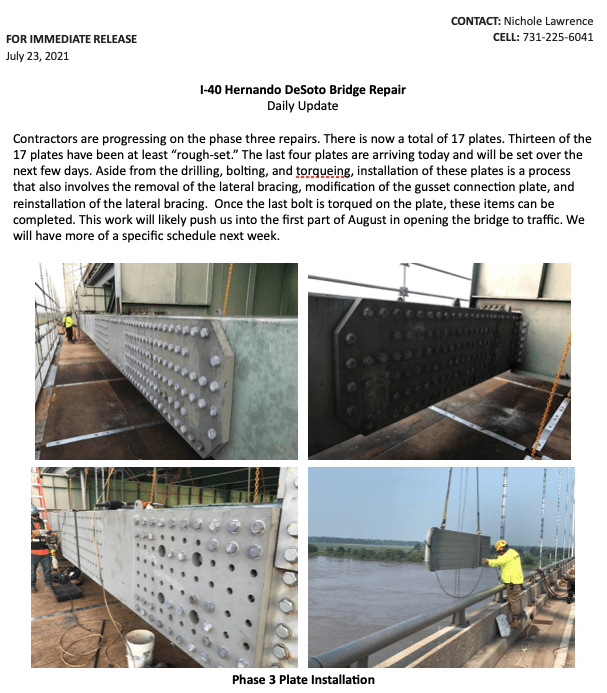

Craig Neth quoted that 16 plate repairs will be required. Maybe each repair is unique and won't require the same amount of plating? Then again, it sounds like the failures are systemic so they'll all require the same repair.

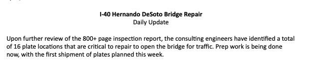

Now up to 17 additional repairs, from today's press release. These 'secondary' mending plates appear to be much smaller than the 'major' repair:
