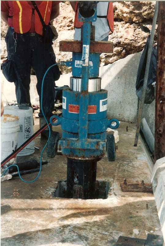

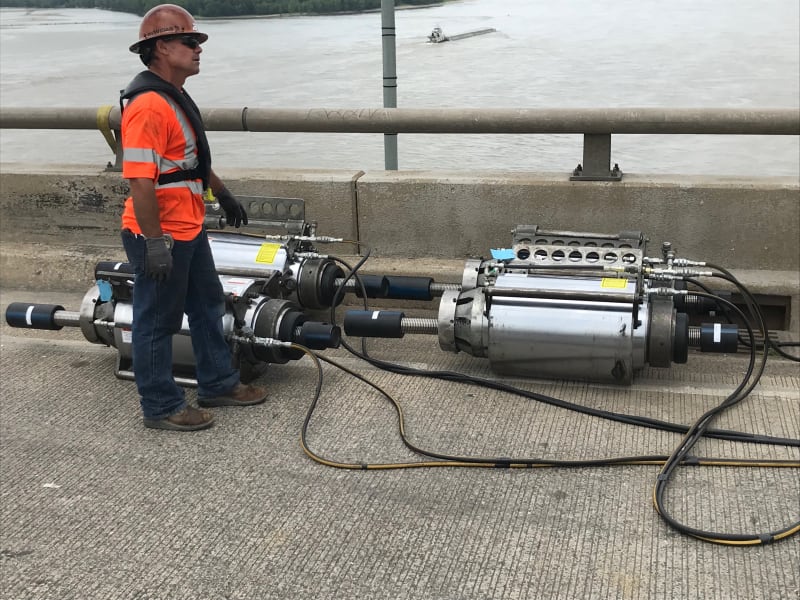

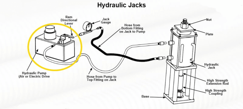

Most likely the PT bars will be stressed with a multiple center-hole hydraulic rams.
Based upon info of 4 Jun 21 posts above, the 8 x 3" dia PT bars shall provide 3,000,000 lbf of preload, so that is only 365 kips per PT bar (about 54 ksi service stress for an ultimate tensile capacity of 150 ksi). So a 200 ton capacity ram would 'theoretically' work.
Elongation over 150 feet will be approx 3.5"
For scale, the following photo is a 200-ton center hole ram over vertical rock anchors (PT rods of 2-1/4" diameter). Stroke is 8" and weights approx 320 lb. 4" dia center hole.
Something like this, only bigger.
Thanks to Epoxybot for the original image.
There are other types but this illustrates the basic principle.

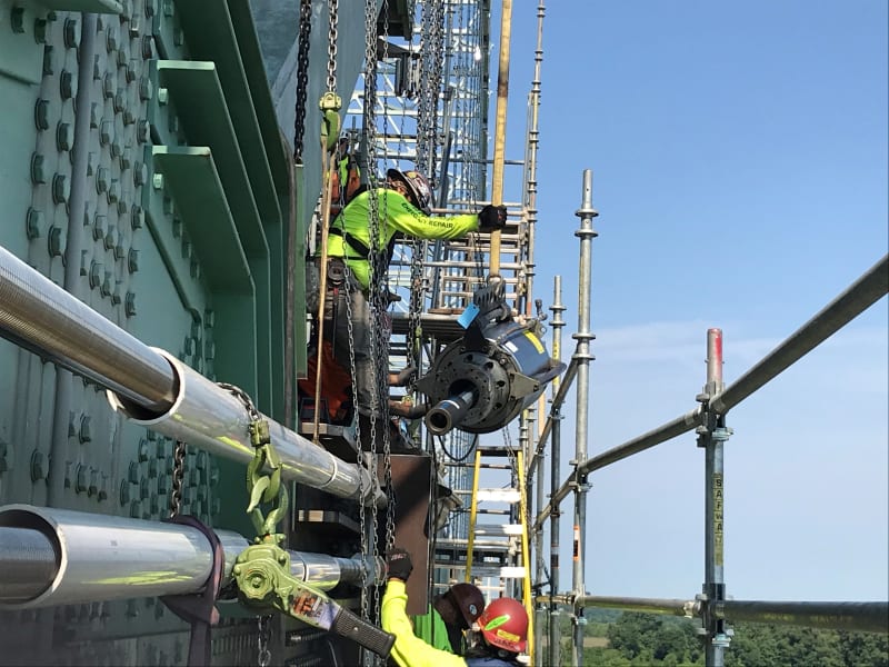

Hydraulic Bolt Tensioning rams are likely going to be used, as they allow tightening the nuts with out interfering with the ram.
(NordLock)
These are often used on slew ring bolts, and other similar bolted connections where it is desirable to avoid twisting the bolt when applying tension.

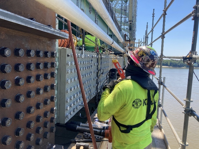

Lots of updates today!
From Link:

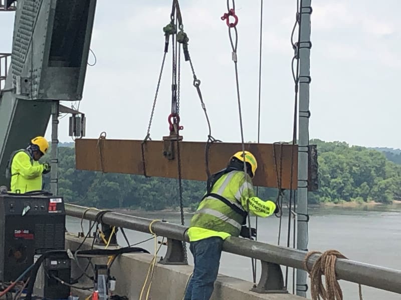

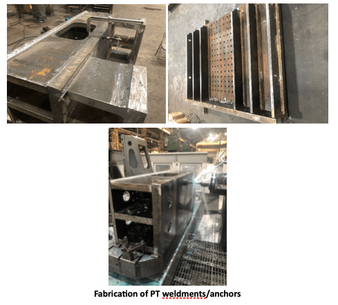

Here's the latest on materials/fabrication:
[ul]
[li]3,000 bolts for the post-tensioning (PT) arrived Wednesday. Crews are replacing old with the new one by one.[/li]
[li]The PT weldments/anchors, fabricated by G&G Steel out of Russellville, AL, will be delivered this weekend.[/li]
[li]The PT rods are being fabricated. The first shipment is expected Monday, 6/14.[/li]
[li]Steel strengthening plates and splice plates for the permanent repair are also being fabricated. No timeline yet for delivery.[/li]
[/ul]
Construction work expected through the weekend:
[ul]
[li]Hang additional rigging for Phase II work[/li]
[li]Finish miscellaneous steel removal for PT and Phase II work[/li]
[li]Attachment of PT anchors/weldments to the tie-beam[/li]
[li]Hang PT rod supports from floor beams in preparation for PT rod delivery on Monday[/li]
[li]Install Lower PT supports and protection on the platform[/li]
[li]Cut holes in floor beams for PT rods[/li]
[li]Remove and replace stiffeners at floor beams[/li]
[/ul]

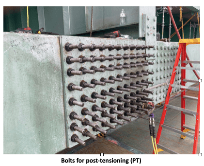

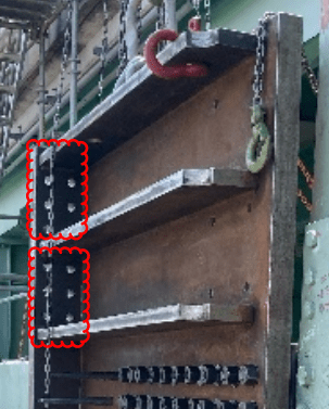

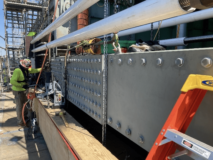

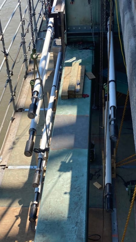

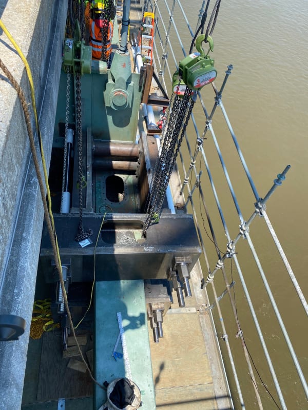

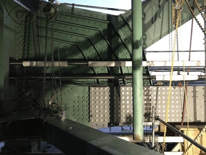

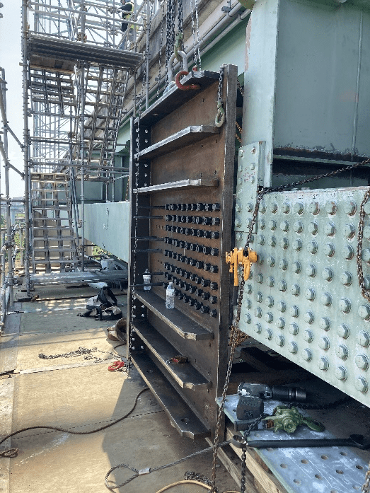

It is interesting that with each 3" dia PT bar I was expecting each to pass through the bearing plate, however, based upon the photo they must be terminating the 3" dia PT bar before the bearing plate and transferring to a 6 bar/bolt yoke connection for preloading etc.

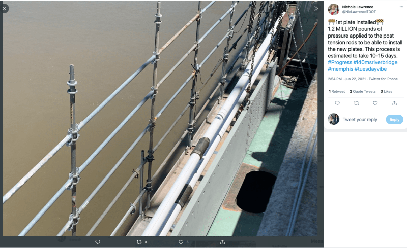

Tdot posted a picture on twitter today that shows the PT bars being installed, you can now see how they are transferring the load to the previously installed weldments.
TDOT posted some pictures of the hydraulic jacks this morning on Twitter:
Link

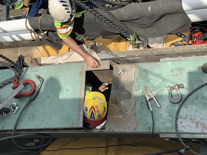

Update today, and a picture of the failure area:
Here's a slightly bigger view of the fracture area picture, scraped from the Word doc. Does the fellow inside have to run the plasma cutter???
Link
∧ Note the curved cut traced out for specimen "2B"; they must think there's still load flowing through that inboard plate, and so do I.
Based on the photos posted by IRstuff above on that weld seam split, and the photos of the rest of the crack, I'm thinking the tie never had its load significantly relieved. Methinks <15% was redistributed.

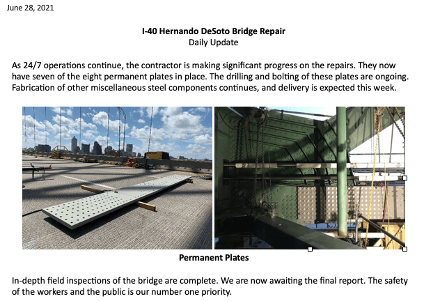

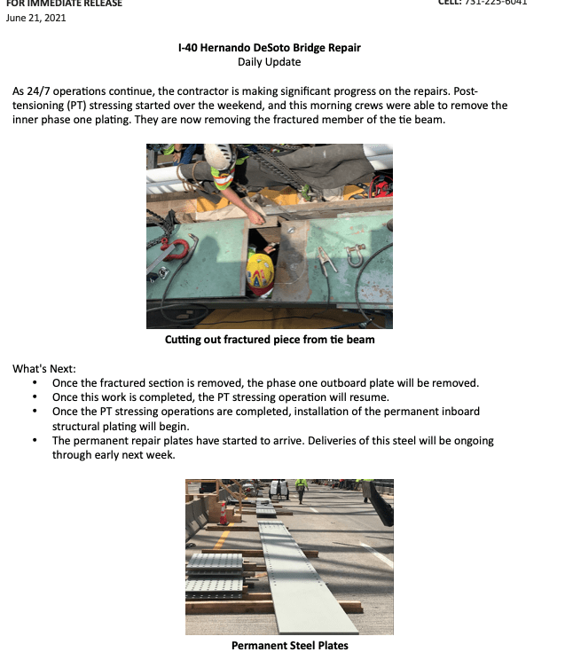

Today's update from TDOT:
Bigger picture of some of the interior 'mending plates':
Link
