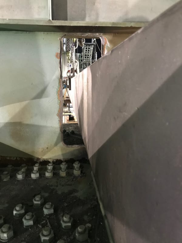

This one shows exactly how the mending plate is offset from original plates. The crack is to the left, just off the edge of the image. Not clear that you have to log in to see the photos

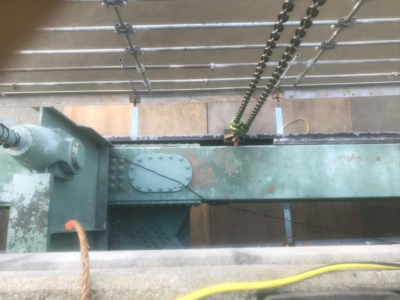

1- The mending plates prevent access to the gusset/splice plate bolts so the repairs cannot involve any work to that area.
2- The long unsupported length of the mending plates should only be adequate to resist tension forces.
3- After the repair is complete, the hundreds of holes drilled in the member for connection of the mending plates will remain, or be welded shut, I think. I wonder how this affects the strength of the box member.

The update from May 27 said something about "...removing a smaller section of the fractured piece...". Why do they have to remove it, and how would they remove it with the repair plates in place?
I'm having a hard time imagining how they can make further repairs without an extended shutdown and without removing the repair plates there now.
It's not making a lot of sense right now. The don't have much access to the crack or the splice plates to work on it. It doesn't make sense to be leaving all those bolt holes after the repair and cutting that big hole in the deck support beam that has to be repaired later doesn't seem to be a great idea either. It will be interesting to see how this proceeds.

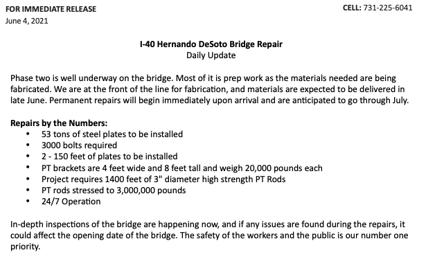

From ENR today (06/03/2021): Link

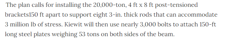

So I am assuming the PT is longitudinal (and temporary) over the 150 foot to apply preload, so that the 150ft long permanent steel plates can be installed, with 3,000 bolts.
8 each x 3" thick (I guess they mean dia?) rods - lets assume they are 3" dia @ 150 ksi PT bars, with 6.85 in2 of net area each rod x 8 rods, so at to achieve 3,000,000 lbf that equates to a prestress of 55 ksi - so about 36% of MUTS, seems low but ballpark.
Not sure what the 20,000 ton refers!

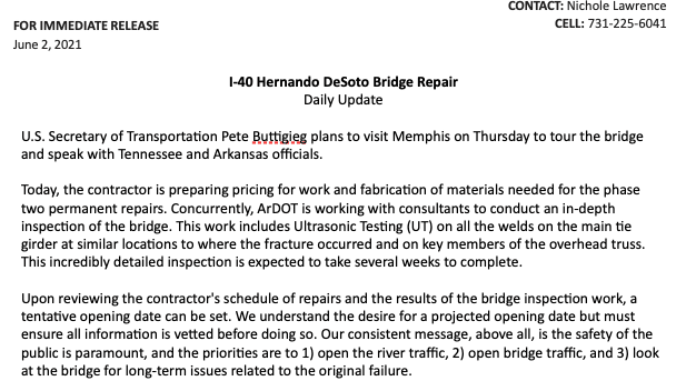

Here is TDOT's press release of what is to be done, maybe fills in some blanks in the ENR report:
LINK
