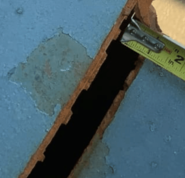

Some pretty serious looking issues here.
Might be a broken weld...
Is it possible to develop enough force to close that gap with post tensioning strands and jacks to allow the beam to be replaced?

waross - that's a good question and I don't know. But if repairs are moving forward, I can only assume that either they can or that the locations the engineers expect the forces to transfer to can handle the additional loads. Maybe even a combo of the two.
dik - definitely could have stemmed from the box weld. I'm still thinking fatigue but we can both be right on this.
I wonder if there is some sort of torsional stress that happens at this location. Like the wind is hitting the tie beam and cause some wind galloping, fluttering, or something and the beam is torsionally restrained at the connection. This cause some sort of torsional stress concentration, its not large but enough to become a fatigue issue.
From the press conference, it appeared that the initial thoughts for the repair would be creating a collar and using tie bolts to pull the beam back together then welding the tie beam.

Two questions:
1. Are those strips backing strips for longitudinal welds?
2. Did those strips break or did they end there?
Bill
Ohm's law
Not just a good idea;
It's the LAW!
I took them to be ribbing to stop hungry horse deformation. And that they broke with the fast fracture mode.
Probably
My opinion is that the weld crack propagated into the backer bar. The pieces of backer bar on the left are visible. The backer bar on the right id hidden by the camera position.

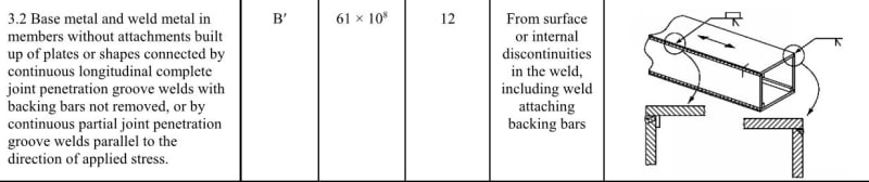

While welds are often made with backer bars, the design needs to consider these welds - just like all fillet welds have "crack like features" in the root of the weld. This sometimes drives a requirement to stress relieve beams when manufactured. If the situation can not tolerate weld root cracks, the backside gouging and welding is necessary, which probably can not be done in this case as the box is too small.
If the base metal is hot short it could also promote weld cracking. Hot short is possible even with a mill test report being to spec. Root cracks can also result from a welder having a bad day defect, and many other things.
WELD CRACKS, DEFINITIONS, CAUSES, PREVENTION & REPAIR
Members with a high proportion of alternating stress with respect to continuous stress are particularly prone to fatigue cracking. It is relatively easy to calculate the tension in the tie beams. It is significantly harder to quantify the variable load for fatigue calculations. Additionally in 1966 (a guess, based on the bridge opening in 1973) when the bridge was designed fatigue theory was not as well understood as it is now.

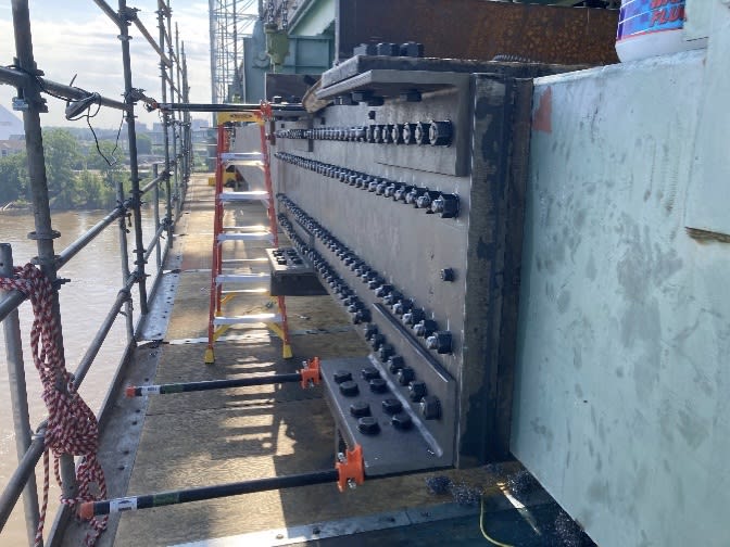

Geez. Someone had to run calculations to include the weight of those plates in the dead load. [bigglasses]
Brad Waybright
The more you know, the more you know you don't know.
Unless the bolts pass all of the way through. That might explain the extra thickness in the plates.
The extra thickness can also be explained by needing to use the plate on hand that was thicker than the minimum required. The alternative might have been additional lead time.
Through bolts on a box girder splice would be a poor joint design. The squeezing forces would wind up stressing the box beam corners - which already are cracked.

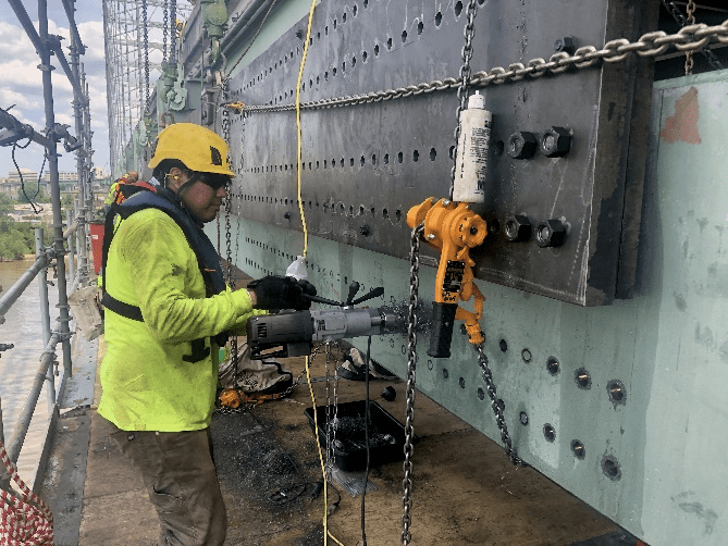

Can you imagine being in that beam while someone with a 1" impact wrench is wailing away on the other end of the bolts?
I'm impressed that guy with the mag-drill could punch that many holes that line-up well enough to match all those plate holes.
Hey! How did they get the bridge beam re-aligned so holes could be accurately drilled? (chicken and the egg issue)
