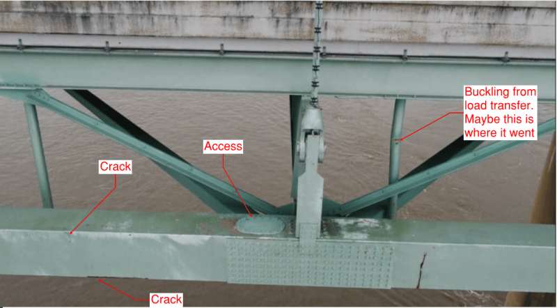

Some pretty serious looking issues here.

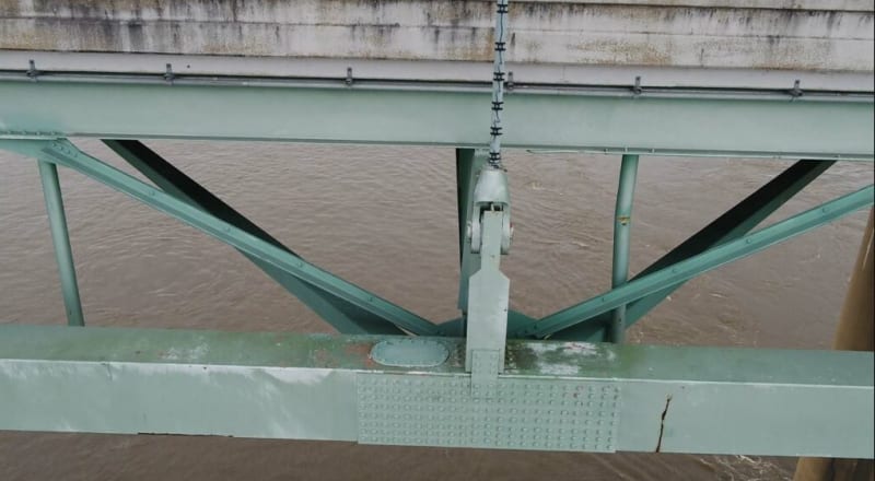

Here is another photo linked above by @azcats :
I assume this is the same location, so it appears that the cracking started at the bottom, outer corner. (the current photos show that the bottom plate is not yet fractured).
I can't believe they would leave a crack at least 80% of the web height, without even trying to drill out the crack tip to prevent it from progressing.
per Wiki, the bridge was constructed in the period 1967-1972, prior to trade with the PRC, so that issue is not applicable. It may yet be a metallurgivcal issue, so let the metallurgical experts figure it out.
During that time period, some CS components fabricated in Spain had metallurgical issues, so it might be useful to review the QC documents , at least regarding the source of the steel.
Some of the information starts to make sense - the picture from above (IRstuff) indicates that the shape of the crack has turned the beam (Really stiff in tension) to a sort of spring (still stiff but much softer than the opposite side, which is uncracked), This could explain the asymmetrical behavior reported by TheGreenLama.

Also in the new image is the bolted cover for the access hole. They likely has some very small workers on the crew to use an access hole in this location. I would think stress would be higher at the access hole, then the crack location.
You can only think that someone thought that crack was just some sort of surface mark unless they were only watching it live on the little screen the inspector is using. You just wouldn't see it on that.

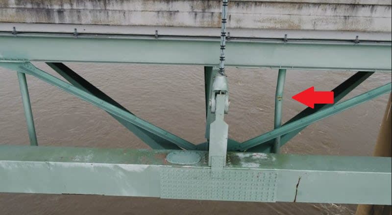

That pole sparweb pointed to isn't structural, it's a drain pipe from the roadway, but has been hit by something.
Were the vertical cross spars added later?
A few thoughts on the photo. Repairs are going to be extensive.
The vertical 'pipe' that appears on the right in the photo above is likely just a drain pipe extension, i.e. non-structural.

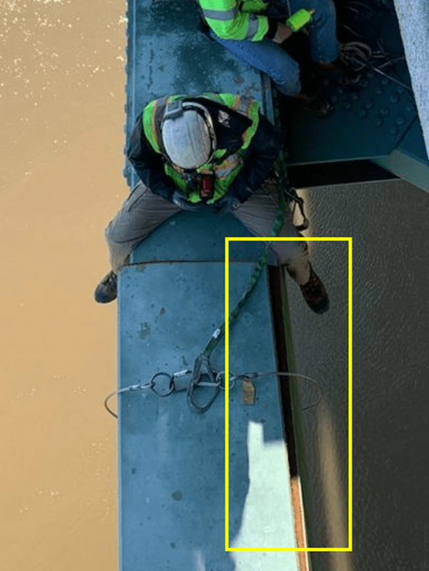

This time the crack was visible to the naked eye looking down from the deck so a lot more visible.
But there do appear to be more visible cracks in the tie so I wonder if they are now doing a rather more thorough inspection while the bridge is closed...
