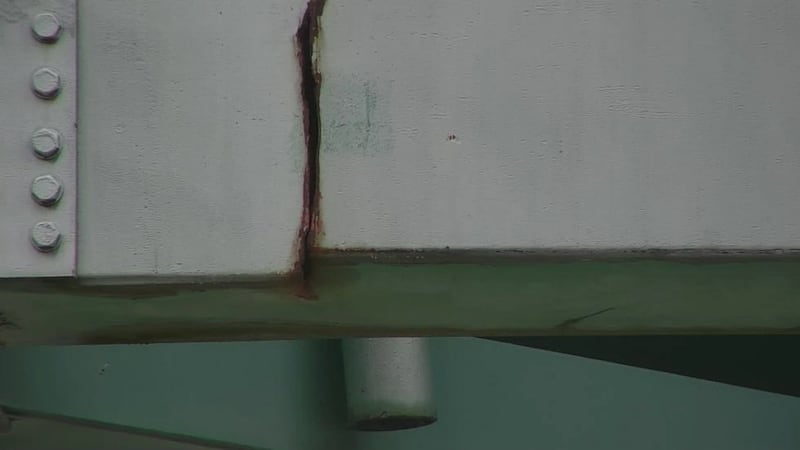

Some pretty serious looking issues here.
Not a bridge engineer, but just looking at the number of bolts in the that box beam's web splice plates there looks to be better than a 1,000,000 pounds of bolt shear capacity. Assuming such significant tension? load I would have expected major/significant splice plates on the top and bottom also to better engage the entire box beam and smooth out the load transfer and associated stresses when load is transferred from the splice plates to the box beam section. Wonder if that splice detail gives rise to unforeseen stress concentrations then along with cycling/fatigue you have what you see. Of course this is assuming that entire box beam section is required design wise. Going to be interesting to see the final report on the root cause.

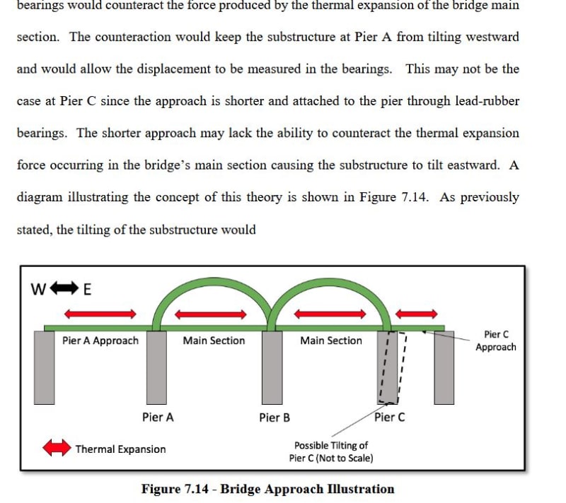

Structure was behaving unsymmetricaly back in 2017. If I'm interpreting structural monitoring report properly (from 3DDave above), span with fracture was showing reduced loading from temperature forces back in 2017, which resulted in new bearings not moving anywhere near the amount as the ones on the other end. This was interpreted as possibly the result of foundation movement. In light of this failure one could draw other conclusions.

Given that photo, I feel like opus might be on to something and this is maybe shear lag related.

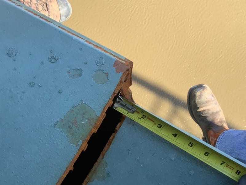

From the amount of rust visible, it would seem that this break has been there for awhile.

Not recent, and I don't think I could have cut that member that nicely; I cannot imagine how it failed so cleanly... as the doc noted... maybe the duct tape failed.
No bifurcation to indicate fatigue and no plastic deformation. Not qualified to make this observation but this failure looks brittle.

I cannot imagine a weld failing that cleanly...
My understanding is that highway departments have long has a distrust of welded structures, and particularly field welds. The box section could be a weldment, built in a shop. The field connections are all bolted. The box looks big enough that a worker can get inside so handholes for access to tighten the nuts are not necessary

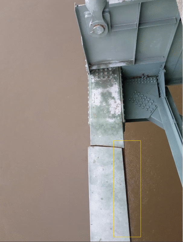

To my eye, the second image I posted on 14 May 21 21:50, does not look like the member has completely separated. It also looks like a small crack is progressing from the opposite side, just to the right.
