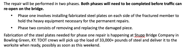

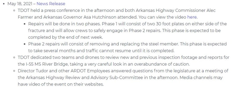

Per one of the TNDOT press releases, sequence is something like
[ul]
[li]Stabilize the crack[/li]
[li]Design permanent repair[/li]
[li]Install jig to allow installation of replacement beam[/li]
[li]Install replacement Beam[/li]
[/ul]
If more cracks are found - repeat as many time as necessary.
Reopen for traffic
Design of the permanent repair should take into account understanding the cause of the crack, to prevent a repeat.

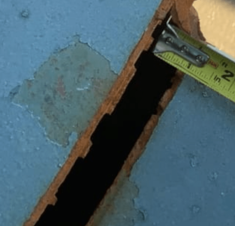

The DOT site shows a great picture of what I was trying to get at earlier, the top surface of the beam is clearly separated from the rest of the beam

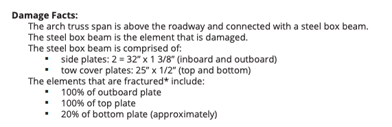

It's a box beam:
Snooper truck definitely sounds like a plausible source of some of those dents and dings...
^ based on the box beam having 1-3/8" (35mm) vertical plates and 1/2" (13mm) top and bottom plates, it takes away from the theory the shear lag is the culprit (with the connection on the vertical plates only.
The source is more likely the weld that formed the box. By the 1970's, they should have been smart enough to not have stitch weld connecting members on a cyclically loaded structure. There is a close up photo above, it looks like the thinner top plate runs over the vertical plate about half way, and it's connected by a fillet weld. That shouldn't be a too bad fatigue category.

I've been intrigued by the end of the broken bits seemingly showing a castelated joint. This is a blow up of one of the photos above.
Anyone an idea of what this could be?
It seem too regular to be the result of the fracture.
