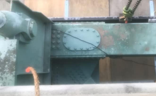

Some pretty serious looking issues here.

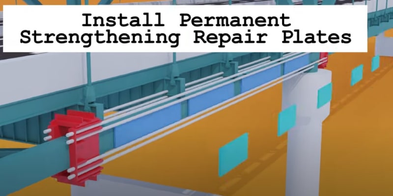

So the video posted by TDOT shows how the bridge will be temporarily supported to allow access for repairs. How the 'permanent strengthening repair plates' are to be employed remains a mystery.

So it looks like they are adding extra steel plates in between all the existing bolted connections and then adding a further plate to bridge around the bolted sections.
Nothing about removing the damaged section or even sealing it.
LittleInch is correct. It's easier to see the pieces if you step through the fast animation.
Still not much detail there. If that animation is to scale (probably not) it looks like the first set of plates actually overlaps part of the bolted node connection next to the failure. Then, the second set of plates overlap each end of the first. That would leave a gap between the new repair plates and the original steel and connections. That would certainly not lend itself to assisting with ongoing maintenance operations. Also, not able to determine if this stuff is bolted in place or welded. I'm not a civil, bridge, or structural guy, but it really looks like a patch job to me. I hope there's more detail to come out soon to change my mind.

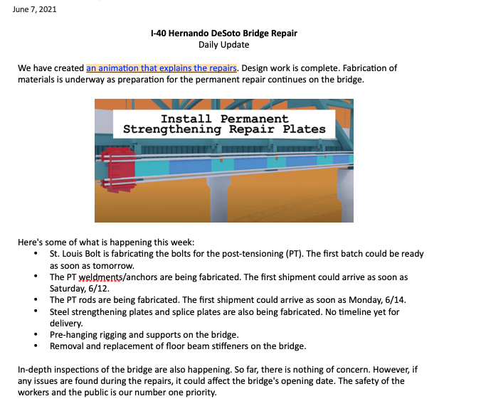

Three thousand bolts are required per June 04, 2021 release.
I'm guessing everything is bolted then.[bigglasses]

Can anyone explain why they need to remove and then reinstall the "floor beam stiffeners"?
I think they are connected to the inside of that member where repairs are required
Brad Waybright
The more you know, the more you know you don't know.
Yep, you can see the end of one here.
Some slight mods will probably be required to reinstall them.
Are the permanent repair plates on both sides of the beam or only on the outboard side, as it appears in the video?
Do the repair plates compensate for the weakened top/bottom sides of the original beam? I can see where the top outboard joint is rusting, near the break.
