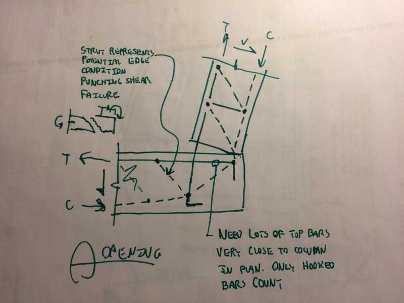

Do the following file pictures (of construction done 2 yrs ago) fulfill these special detailing? The following shows all the bars of the edge column put at the bottom bent... and the last picture shows the steel bars plans of the combined footing:
The following is before top bars put:
The following is after top bars and extra bars put:
The following is the rebars details of the combined footing (it's the top and bottom combined footing, the middle combined footing is large at 3 meters width and 12 meters length.. all has foundation depth of 0.6 meters 4000 psi concrete)
What do you think?
You're detailing's pretty decent in my opinion. Better than most of what I see in practice. There's definitely a load path there. The only question is whether or not that load path can actually develop the required strength.
To be frank, I doubt that the connections that you've provided are adequate to supply the required strength (over-strength yield moment of the columns). Of course, I've no way to know for sure without running the numbers myself. That's just my gut feel.
Please don't interpret my comments here as mean spirited. My intent is to be helpful, not critical. One of the nice features of an anonymous forum like this is that we can discuss these kind of issues more honestly than we might be able to were we working in the same office.

Not much. In a special moment frame, you have to develop a moment connection capable of resisting the flexural over strength moment in the column. I get that at about 270 kN*m.

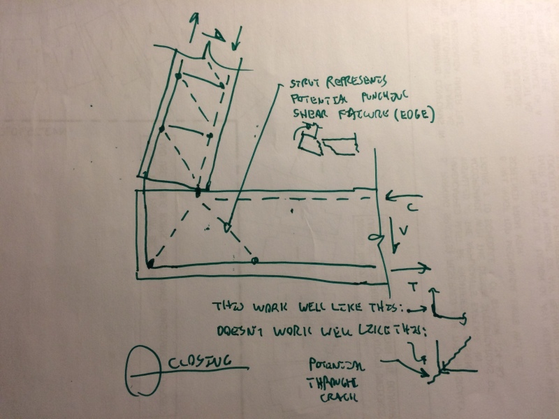

A special concrete moment frame has to develop plastic hinges at the column bases. As such, the moment demand at the base of the columns is equal to the over strength flexural capacity of the columns at minimum.
I spent hours reading many references and books of how to compute for it. Do you know of a reference that shows how to compute for it. The Vc or shear capacity of the foundation at 2.5 meters width and 0.6 meters depth is about 1200kN. With 270kNm as moment capacity of column at over strength (at yielding plastic hinges). How do you compute for the moment connection capacity? I can't find it in ACI too. In the book it's written "To ensure the integrity of the junction between column and footing, ACI Code 15.8.2 requires that the minimum area of reinforcement that crosses the bearing surface (dowels or column bars) be 0.005 times the gross area of the supported column." For special moment frames.. any references exactly how to determine it? Thanks a lot.
You can check the capacity using strut and tie procedures applied to the opening and closing models that I sketched above. Another way to look at it is to flip the model upside down in which case it becomes much like a roof level slab to column connection. The 270 kNm that I mentioned earlier was a ballpark number based on having to yield 8-20M column bars to over strength at a lever arm of 300 mm. I'd come up with a detailed estimate of your own before investing too much time on it.

The tie beams will help a lot. You'd want the hinges to form at the top of the tie beams. You'd need to run some numbers to verify that though. That way, the end column to tie beam joint becomes critical rather than the column to footing joint. That's much better. Since your columns are bigger than your grade beams, developing the flexural over strength of your end columns may still be a challenge.
