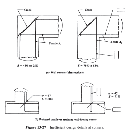

I want to determine if my edge column overstrength moment can be taken up by the foundation connection and detailing. If not. Then would go for retrofit of the existing tie-beam, maybe even replacing all the soil with concrete to change the plastic hinge above or reinforce the tie-beam with thick metal plates to transfer the plastic hinge above. Of course I'll find an expert in my country (if there is even one) for this. So I just need some initial thoughts of how to discuss with him.
Also if you will see the first picture above. The slabs are thin. But my foundation is very thick compared to the thin slabs presented above.. my foundation is 0.6 meters deep and 2.5 meters wide. Using the Vc equation of 2phi* sqrt (fc')* bw x d .. my Vc shear capacity is about 1200 kN. Now with 270 kN.m overstrength moment of the column.. can't you just use Shear x distance to get *rough* estimate of the moment capacity?

a) crossing the potential yield line in the sketch that you clipped above and'
b) developed past that potential yield line.
It's very astute of you to make this observation. The ACI slab method is intended for thin things and strut and tie is usually more appropriate for thick things. That being said, it's more about the ratio of column depth to slab depth than the absolute thicknesses. At 650/400, I'd still consider the slab method applicable. The Wight textbook is one of my favorites. I know for a fact that there's an excellent treatment of two way punching shear in there someplace.

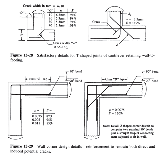

By the way. About eccentric spread footing. It doesn't have top bars. If the joint doesn't have the overstrength flexural capacity.. would it have the same punching shear capacity deficiently or would it compensate by becoming pinned when the entire foundation just rotate against the soil?
Going back to retrofit. Straightening the tie beam joints by enclosing it with metal plates or putting pedestral or even putting mini columns in between the tie beams to support the tie beams may make the connections more fixed and transfer the plastic hinge above.. isn't it.. what is your experience in this and what could be possible retrofit you think can work in the column-tie beams joints and below to make the plastic hinge develop above? Many thanks.
By the way Kootk.. is the potential yield lines where the cracks would be?
Or is it in the same area as the 2 way punching shear?
Do you have picture of any such cracks where it differs from the punching shear cracks?
Also in sides.. the columns are bowing inwards because of eccentric loading so the CLOSING case is more the average situation as follows right? so the very closed spacing of longitudinal bars near the yield lines is not the for the "closing" loading case or scenerio.
I think the opening would only occur during reverse cyclic loading.. but if the columns are bowing inwards in the sides of the structure.. won't it be possible there is no reversed cyclic loading and the "Opening" case won't occur?

It was just the generic punching shear design and not the yield lines. There is an odd feature built into how punching shear is checked. Punching shear checks are predicated upon concurrent, correct flexural design. This is not always apparent to designers, however, as the presentation in codes rarely highlights this. Basically, if your joint flexural capacity is junk, so is your joint shear capacity. This article does a good job of explaining this: Link
I have read your link over and over again as well as more references for hours in preparation to presentation to the designers. Last time they failed to understand what I was explaining about stress-strain diagram and pure epoxy (not epoxy grout) filling up of voids. In our country. We fill up even 2 meters of voids in high rise building column bases with epoxy (there is no other solution).
Anyway. In reading all the references about yielding lines at slab-column that doesn't use beams. I realize they are all about your CLOSING case.. because the slabs don't anti-gravitate up the air... it goes down or closes with respect to the column. There in the foundation analogy, the bottom bars are the concerns. The yield lines in the books concern the bottom bars. My bottom bars near edge were extensive.
The references on slab-column without beams doesn't handle your OPENING case. Right? There if the top bars of the foundation near the edge is insufficient.. there is possibility of punching shear failure at column flexural overstrengh. However if the punching shear capacity is a lot.. it may make it. I don't think any insufficient top bars can crack the top in tension (like in bottom of beams in tension). Would it? Using the strut and tie analogy. Any insufficient tie in the Opening case would mereLY cause punching shear.. but if the punching shear capacity is a lot.. it may calc out.. what you think? I just need to master the concepts so I know how to debate with the designers.. so many many thanks Kootk.
After reading many books more. I finally got your core ideas. Kootk.. I finally am confident how to present the ideas to my designers. The moments of the column has to be carried to the footing.. and moment transfer by shear stress is not enough to do it.. but has to be carried by flexure. I'll emphasize this to them tomorrow. Because they would reason 2 way punching shear can take care of both moments and axial load. I'll say this is the not the issue I'm concerned.. but the yield of the joint itself just like column flexural must be stronger than beam's flexural. Last time I tried to share them ideas of stress-strain incompatibility of concrete and pure epoxy. They won't believe it. So don't blame me if I get a bit paranoid on all this. So many many thanks to you Kootk. I think you must get a reward for great service to the public. You would make a very good educator perhaps as professor :)
