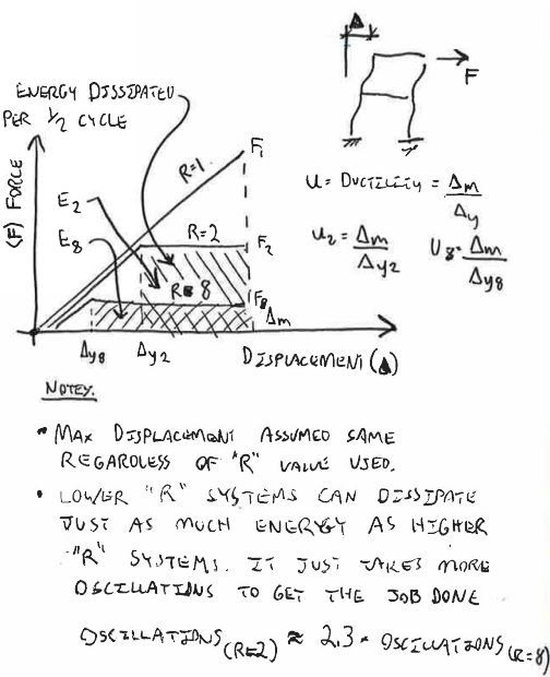

I made you a spiffy sketch mes7a (below). If you study it carefully, it will reveal a fundamental principle that is built into modern seismic design provisions but isn't discussed much. That principle ss called the Equal Displacement Principle. If you google that term, you'll turn up a ton of related explanatory material.
The gist of the equal displacement principle is that a building lateral system will experience approximately the same amount of displacement under design seismic excitation regardless of the level of ductility built into the system. Whether it's R=2 or R=8, the total displacement is the same. The only difference is that an R=8 system would experience more of that displacement as plastic deformation and less as elastic deformation.
In the end, an R=2 building will dissipate just as much seismic energy as an R=8 building. It will just take more oscillations to do it. In the example shown below, the R=2 building wold require 2.29 times as many oscillations to dissipate the same amount of energy as the R=8 building.
The take away from all this is that, fundamentally, a low R building is no more dangerous seismically than a high R building so long as the design seismic forces are adjusted appropriately. Of course, if your local building code flat out prohibits low ductility systems, then that is another matter. The one difficulty with low R design is that it's very difficult to predict seismic loads accurately. And high R systems tend to be more forgiving. That's why some codes prohibit low R systems in high seismic regions.

You're heading off the rails here mes7a. Think of it like this:
1) If all parts of your building were SMF compliant, we wouldn't be having this conversation.
2) Some parts of your building are SMF compliant (columns) and others are not (footing connections).
3) Because not all parts of your building are SMF compliant, you do not have an SMF (mike's point).
4) What you're left with could be conceived of as an OMF or IMF in which some members, but not all, posses more ductility than they require in order to satisfy OMF/IFM requirements. Good for them.
5) In no case would SMF detailing cause an otherwise acceptable member to be unsuitable for use in an OMF/IMF.
