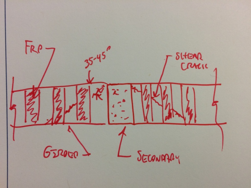

When the designers design my girder with secondary beam framing into it. They use stirrups spacing of uniform load. Later I told him after construction is finished that his spacing is wrong (as commented by others). Then he realized it's true. The shear should not be from uniform load but instead look like this:
Anyway. For secondary beam framing into primary. Does the shear cracks look like the following?
Indian structural engineers I consulted said the cracks occur 2D away from the point where secondary frame into primary.
Is it true? My fear is it may be closer to the center.

Again my main question is. During cyclic loading.. would the cracks at midspan where secondary beam frames into it be 2D away from midspan or nearer? What is your experience of this? I got nervous for it for months about it a year back and still now.
Your concern is whether or not the shear cracks will be crossed by the FRP stirrups, right? If so then, yes, your cracks should emanate from the top of the beam and emanate downwards to cross the FRP stirrups.
The shear detailing of your beam would satisfy ACI requirements. In my jurisdiction, however, the practice is to provide "hanger" reinforcement stirrups right behind the supported beam. See the sketch below. This practice has always been debatable, however, as zillions of beams get cast in the US without hanger (suspension) reinforcement and nothing terrible ever seems to happen as a result.
But FRP doesn't work. I have spent over 2 months reading about it 2 yrs ago. It can debond from surface before it breaks.. so I don't trust it. Instead I trust on the original stirrups. If the cracks angle is like you described.. some of the original rebar stirrups can cross it. But the problem is that in seismic movement and cyclic loading.. the plastic hinge can form at midspan and the shear cracks can be anywhere. See:
This is for beam with uniform span in cyclic loading. Do you have picture of how it looks like when a secondary beam frames into the primary and it is in seismic cyclic loading? Where would the plastic hinge form? Right at midspan? Then the lack of original rebar stirrups worry me at times.

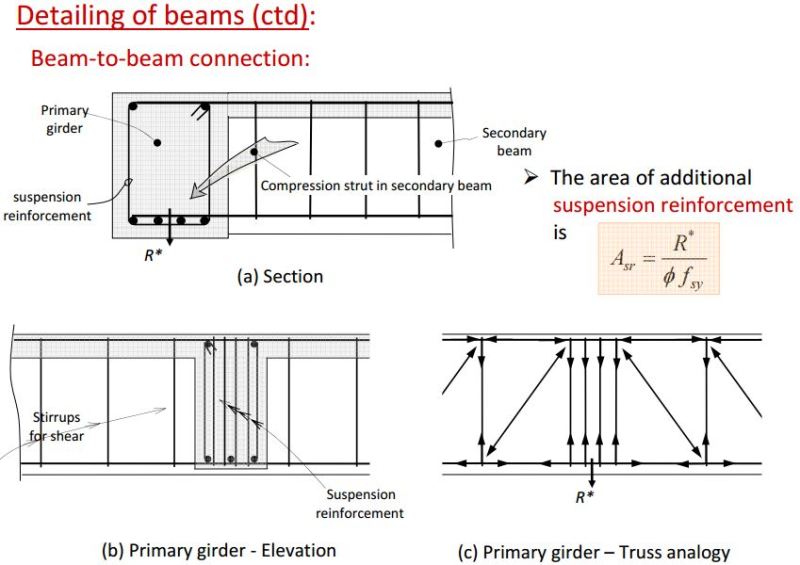

About hanger reinforcement, I actually got worried about it 2 years ago and discussed it with indian structural engineers. The figure is from "Leonhardt, F. and E. Mönnig 1977, Vorlesungen uber Massivebau, Dritter Teil, Grundlagen zum Bewehren im Stahlbetonbau, Dritte Auflage, Springer-Verlag, Berlin, p. 246"
It seems when your secondary beam shear is more than Vc and the it can suffer diagonal crack that you really need to worry much. The drawing of the compression fan (from Mcgregor presentation of the 1984 Canadian Concrete Code 6-29)
It seems internal Hanger stirrups are only required if V (shear) at the end of the supported beam is beyond a certain threshold that can cause diagonal cracking. Dolan Et Al mentioned "Hangers will also be unnecessary if the factored beam shear is less than 0.85Vc (as is usually the case for one-way joists, for example), because in such a case diagonal cracks would not form in the supported member. The predictions of the trust model would thus not be valid, and the reaction would be more nearly uniform through the depth."
Another author Mcgregor stated " These provisions can be waived if the shear, Vu2, at the end of the supporeted beam is less than 3*sqrt(fc')bd, because inclined cracking is not fully developed at this shear."
But then it seems you are talking about noncrack secondary beam with the primary needing to transfer the reaction up.
The stirrups can equilibrate the top and bottom bars near midspan.. so it's my hope 2 years ago the beam won't just fall down. But then during reverse seismic loading (up and down). It may stress it. One more reason I want to lessen seismic load of building.

Kootk.. I had difficulty sleeping last night because something kept bothering me. I have thought of it 2 years ago but it's coming back to me.
In the picture you showed above:
The secondary bottom bars are resting above the primary bottom bars. There are 4 bottom bars which matches my girder's bars too.
My worry is could the bottom bars just fracture from the weight of the secondary beams (since there is lack of hanger reinforcement you mentioned.. although I had one internal hanger inside (10mm hoop). How do you exactly compute for the bar sideway tensile strength.
Using area of 20mm rebar as 0.000000314 and tensile strength of 414 MPA.. if you multiply the two, you come up with 130 kN. If there are 4 bars.. total capacity is 520kN? But it is sideway. How would you convert it to sideway capacity of a rebar?
Do you think all the load are being concentrated on the 4 bottom bars of the primary girder beam? If not.. how many percentage roughly? How do you analyze it?
My equivalent axial load of 2 secondary beam framing into the primary girder is 350kN.. Do you divide this by two to distribute it to the 2 bottom bars of the secondary beams framing into the primary?

ACI Vc shear procedures encompass a variety of things that contribute to shear resistance including friction at the compression block, aggregate interlock, and longitudinal bar dowel action. While the dowels add something to the shear capacity for certain, I wouldn't want to rely on them as the sole means of shear transfer.
You've used dowel tensile strength here when the relevant parameter would be dowel shear strength. In reality, it isn't the rebar that fails in dowelled connections. Rather, it is the concrete surrounding the rebar. In this case, the girder concrete below the dowels might spall off. There would be dowel bending at play as well but there's probably no need to get into that.
Why do you call it dowelled connection. I'm talking about the 4 main longitudinal bars of the primary girder beam. The reactions from the secondary beam is towards the bottom as it framed into the primary beam. This is why you mentioned about hanger reinforcement.. to carry the force to the upper longitudinal bars of the primary girder.
Now i'm not talking about hanger reinforcement to transfer the force from bottom of girder to top.. but the shear strength of the longitudinal bar itself (it can fracture when it can no longer take the axial load, isn't it?). What is the percentage of the shear strength of the bar compared to its tensile strength? I heard it is 3/4 or 1/2? You mean the reactions from the secondary beams don't focus on the girder bottom rebars but still carried in the whole section of the concrete? To what extend.. how many percentage approx. does the rebar carry the whole axial load of the secondary beams?

What you've described, in my mind, is a dowelled shear connection.
0.75 Fy at ultimate; 0.58 Fy at yield.
