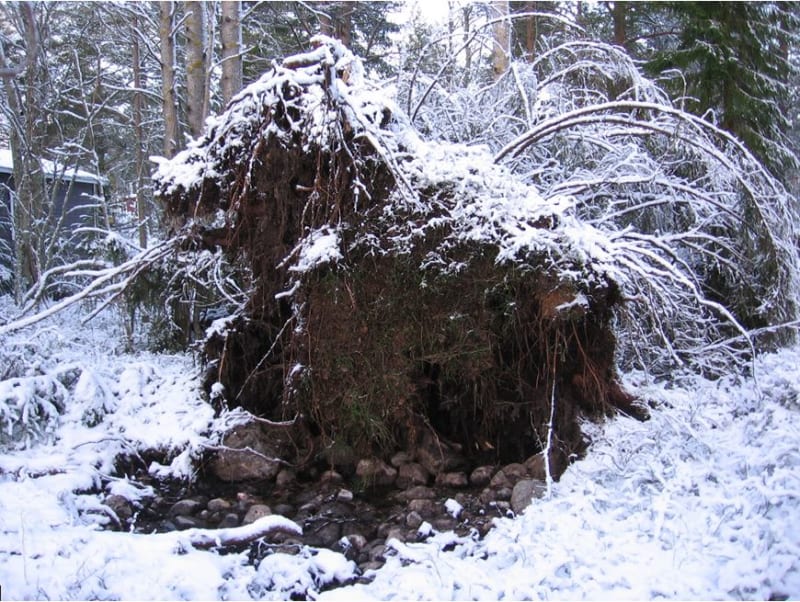

I think we have broken every weather record we had, this last years, warmest, coldest for every month and the most rain, since we started measuring in 1756.
It rained over 200 mm in one month here in October last year 55 mm in 2 days it was what was left of hurricane Sally after it left Alabama.
It rained so much that my septic tank in the summer house has come up from the ground :-(
And 3 large fir-trees fell down luckily not on the house.
Haven't fixed it yet, then came the snow.
