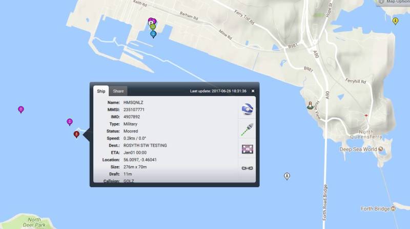

At risk of reopening the debate about warships and AIS...
A.
SOLAS basically says that warships are exempt, but are encouraged to be compliant. Moreover, most warships that are ostensibly compliant might delay AIS information sufficiently to ensure that no tactical disadvantage is incurred.
TTFN (ta ta for now)
No prizes for guessing what that is zeusfaber. :-)
Military Ships would have to have an AIS transmitter with an ON/OFF switch.
The switch could be set to either ON or OFF, as circumstances or whims dictate.
Finding examples of Military Ships with their AIS Out either ON and OFF is expected.
Finding examples of AIS Out OFF over the Internet wouldn't be as straightforward.
It might require a newsworthy collision to make it apparent; as in this case.
IRS:
"SOLAS basically says that warships are exempt, but are encouraged to be compliant. Moreover, most warships that are ostensibly compliant might delay AIS information sufficiently to ensure that no tactical disadvantage is incurred."
I could find no reference to this; can you provide a citation? or, is it perhaps optional at the discretion of the OOD?
