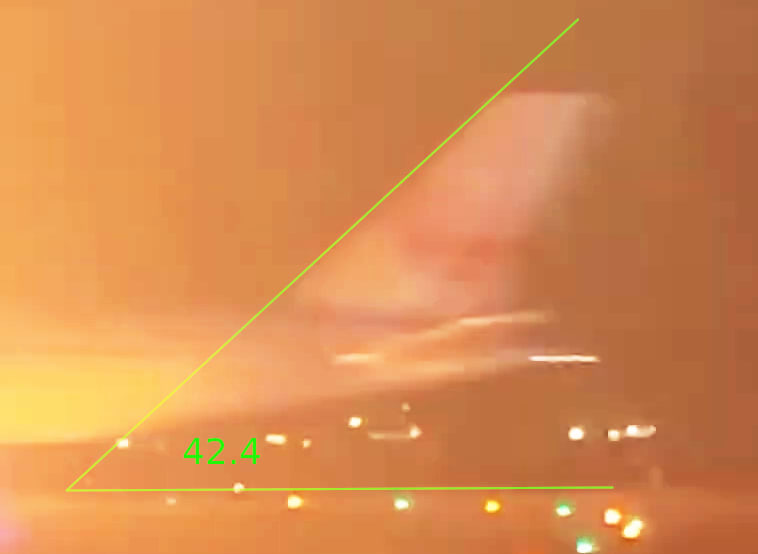

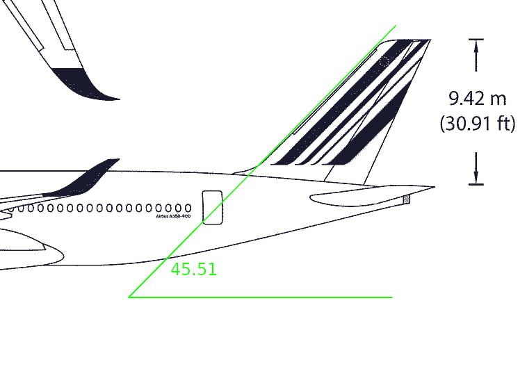

From my earlier post of nose cone damage, a seven foot pitch up at the nose is approx 4 degrees.
From video we can roughly find that pitch up at the time of explosion, possibly when the A350 engine shredded the Q300 wing 30 meters further down the runway, was still approx. 3 degrees.

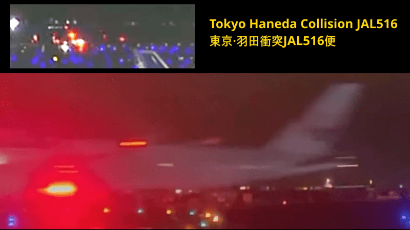

Interestingly, the passenger video from a passing jet catches the last red strobe of the A350 exactly the same as the live cam video. Couldn't ask for a better marker.
I uploaded a synchronized video of the Tokyo Haneda live cam and the passenger footage from a passing plane taxing on Charlie just as the A350 touched down. The passenger video had two extra frames that messed up the work for a bit but once I removed them, the synchronization fell into place using the strobe and explosion lighting as markers. It provides good indication that the nose to tail strike happened immediately at the C-5 entrance to 34R with the Q300 tail being pounded down onto the runway leaving a mark and minor debris.
What is not so apparent in the passenger video is that the nose of the A350 is already through the tail of the Q300 just left of the video frame. The strobe on the A350 flashes just before the engines make contact with the Q300 wings. It's difficult to determine what damage the A350 nose gear did prior to the engine contact. What is likely is that the nose was still aloft when it made contact and the nose gear became detached from the violence of the collision.
Youtube - Tokyo Haneda collision JAL516

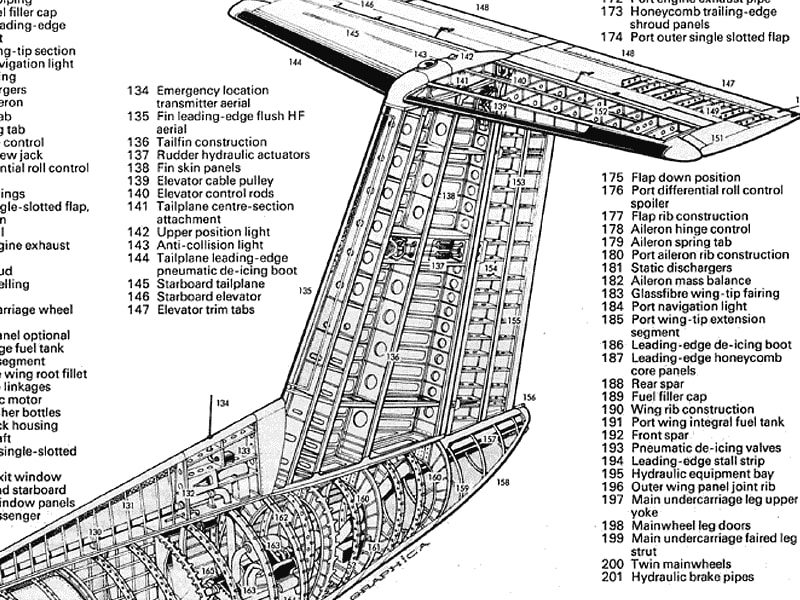

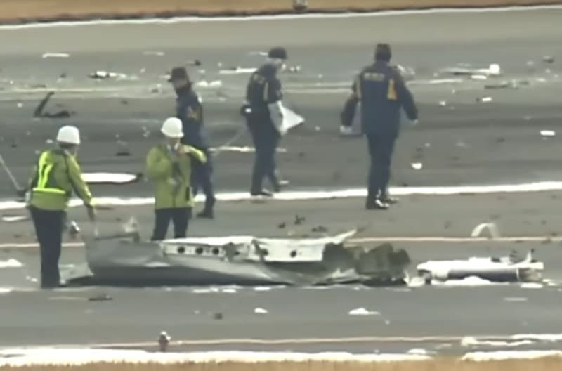

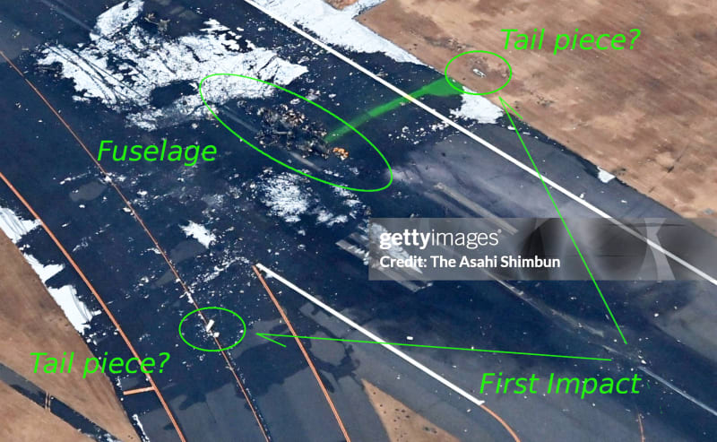

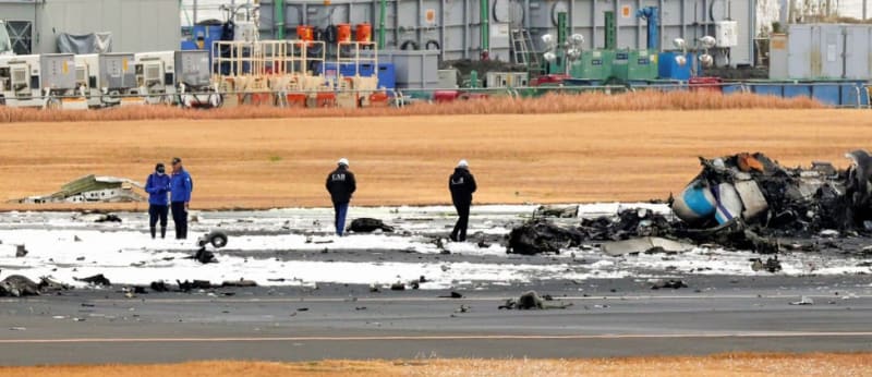

Further indications of the impact location are the debris on C-6 and more debris across the runway. The C-6 debris seems eirily similar to ribbing found in the tail as indicated by a Q300 cutaway diagram. It's more difficult to imagine the debris across the field as being another tail piece. It could also be part of a wing I suppose. If the impact sent tail debris in two directions, that would be quite something.
Debris on C-6
Debris across 34R

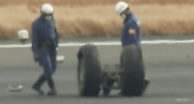

A350 Nose Gear - Location Uncertain

Thanks Sym,
I thought that it looked like the A350 was still 'nose high' at impact but sure hard to tell.
Now we know that it was.
