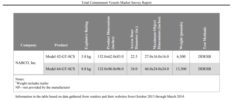

The detonation chamber's maximum capacity is 15 pounds (6.8 kilograms) for multiple uses or 25 pounds (11 kilograms) for a single use, Moore said.
2014 TNT equivalent 2014
The detonation chamber's maximum capacity is 15 pounds (6.8 kilograms) of what. [ponder]
Here it says 15 lbs. MIL-C4
Since everything is recalculated in TNT equivalent it should have sade it could take multiple blasts of 19.4 lbs. (8,8 kg) TNT.

Red, the patent calls out 15 lbs TNT.
The design charge weights for the present invention are:
3-lbs TNT—totally sealed system, repeatable detonations. The UTCV 10 will require decontamination and maintenance, but no repairs.
15-lbs TNT—repeatable detonations with venting. Minor repairs may be required which include mechanical components, ports 68, and flanges (at the yoke 16, door 14, and body 12).
26-lbs TNT—one-time event with venting. Major repairs may be required to all components of the system. However, the system will retain structural integrity during the event.
(same as posted earlier)
I think the manufacturer's description is poorly worded. It should state that it is rated for one time use at charges over 15 lbs and up to 26 lbs. I think the description isn't sufficient for non-engineer types.
Yes I remembered seeing some different values here, but then the Total Containment Vessels Market Survey Report
done by Space and Naval Warfare Systems Center Atlantic in 2014 for Homeland Security isn't correct.
And they claim they took the values from NABCOs homepage.

Considering the patent is in pounds and the market survey report is in kilograms and we now know the people that surround these chambers are bad at math, I'd wager that there was an error in conversion to get the metric number.
Yes I have been thinking about that too but it would have been less then twice the amount and not three.
