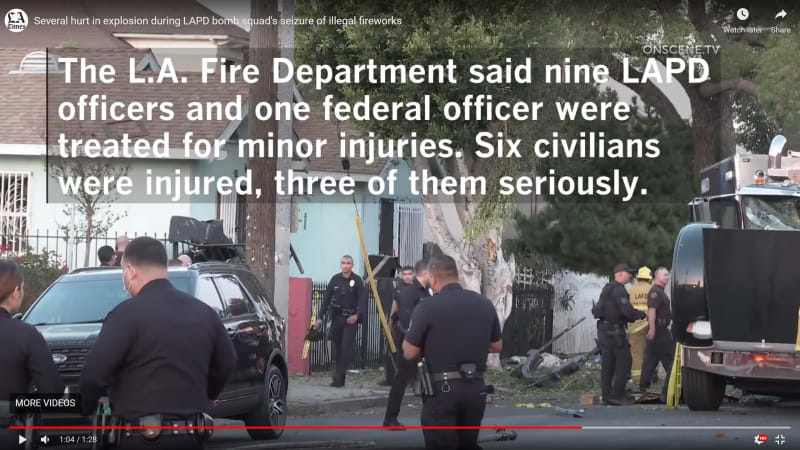

LAPD blast containment truck fails, seventeen people injured 6

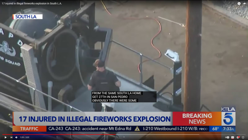

One side of the clamping yoke can be seen in this still frame.
Half of clamp under tree
The other side of the clamp was captured by the roof of the overturned car.

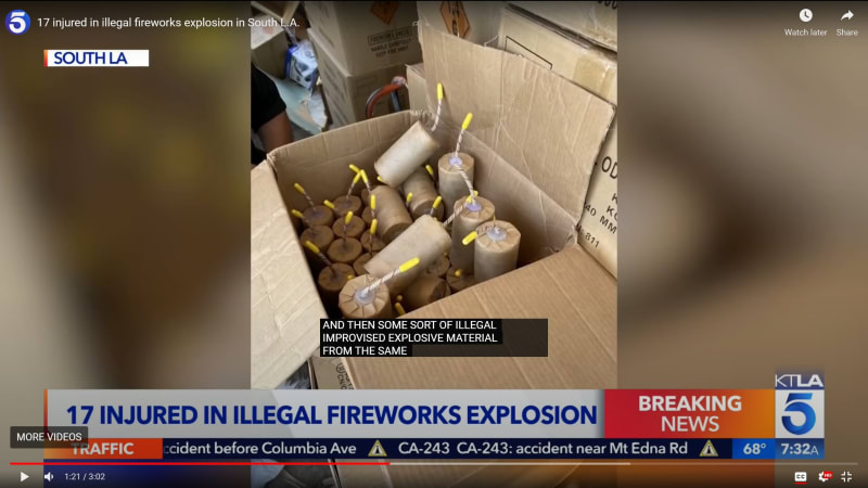

I too am surprised to see a safety cap on an improvised explosive.

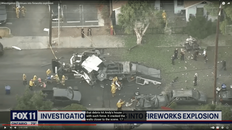

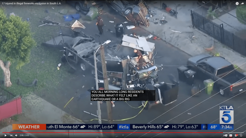

It does appear the door came off sideways and impacted the overturned car as the car is nearly cut in half through the b pillar. I'm sure the lid was deflected upwards and onwards by the car. I have seen the same thing happen with a bowling ball fires from an oxygen cylinder with 4 ounces of Pyrodex behind it.
I think that's half the lock--two halve sliding open sideways--normally?
And I think the door flew WAY over to somebody's house.
spsalso
spsalso,
I think you are correct. The hatch (without its hinge) flew blocks, struck a house and ended up in the yard. One half of the yoke clamp with the threaded rods still attached ended up under the tree as depicted. The other half hit the over turned car. The hatch/door did no strike the car.

They do not look home-made or improvised to me.
I expect that they labeled them as "improvised" because they had no markings and no manufacturing information. Doesn't mean they weren't "manufactured;" there were lots of garage shops in Iraq and Afghanistan that could crank out explosively formed projectiles (EFPs) that were both professional looking and effective.
