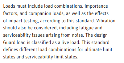

Does anyone treat these loads as the factored load with the design being capable of resisting these loads (without load factors DL and LL factors = 1.0 for both). These are the maximum loads. Dik

dik - Regarding ASCE 7-16, see section 4.5. Note: chapter 4 is about live loads.
It's a problem with the approach for limit states design using probabilities of loads... If the stipulated load is absolute maximum, where does the bell curve intersect the load and resistance? I've always just used load factors... but this has me thinking a bit...

The ASCE considers it as a live load, thanks SE... I'm not familiar with the ASCE... does the ASCE have any provisions for loading that is absolute maximum? see note above re probability of overloading...
