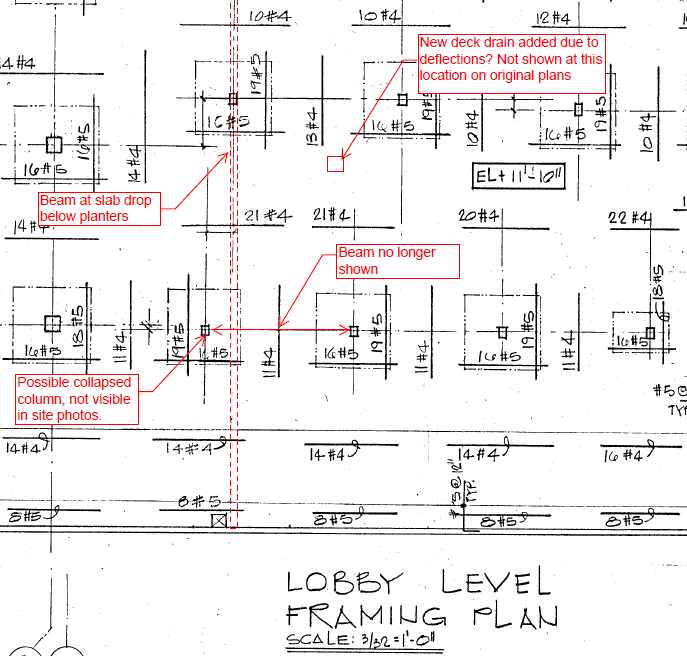

LittleInch said:
So is this enough to make this (the blue bit) the most highly stressed bit of pool deck and hence most likely to fail first?
There i one drawing showing a beam which looks to be in that location but no evidence in the collapse photos.
I don't think it is a coincidence that the beam was removed on S5 Rev.1 Dated 1-17-80. **Corrected below, this was not the most current S5.**
It's also interesting that many of the columns remain, but I don't see evidence that K/14.1 is still standing (edit: visible in photos, but I would be interested is a closeup). If the beam at the slab drop (K/12.1 to K/16) failed at mid-span due to the missing beam, it would create a sudden eccentric load to column K/14.1, possibly causing it's collapse.
One sign that the beam at the slab drop was failing is that there was visible ponding at the location of the added slab drain on the pool deck.

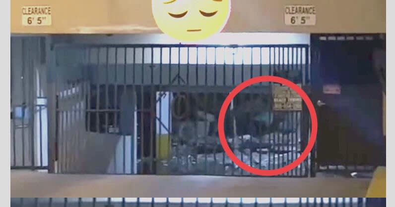

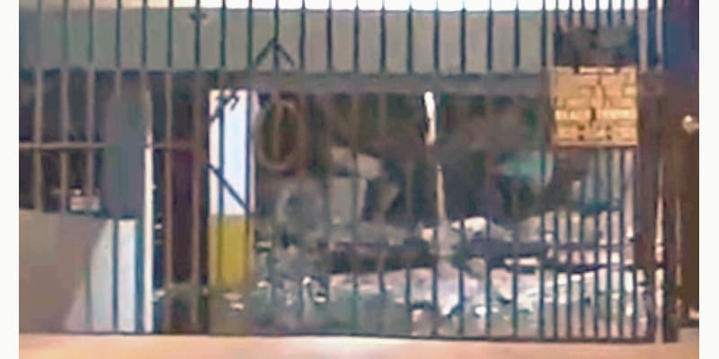

The enhanced TikTok video (from the user above) appears to show the bushes from the 111 planter among the initial debris in the parking garage:

aggualaqisaaq (Nuclear) 1 Jul 21 21:57 said:
... appears to show the bushes from the 111 planter among the initial debris in the parking garage
I believe you're right! Adding a divide layer using the bluish colour of the white "column 27" reveals the greenery (and also further brightens up the scene).

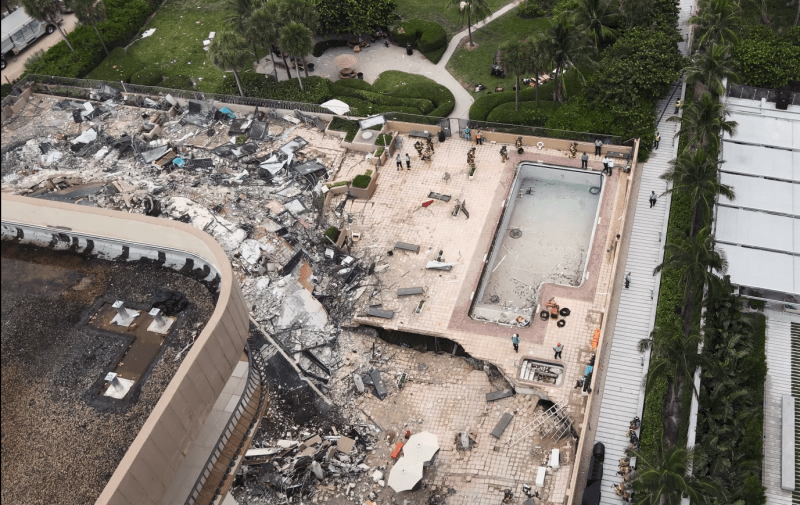

It seems to me that the pool level patio deck failed first. From that point on, the deck is no longer restraining the columns which in turn become excessively slender and buckle resulting in the catastrophic and total failure we have seen.
Why the deck collapsed initially - looks like corrosion of rebar as many others above have alluded to already.
In the event of such a deck failure, I don’t think even the current disproportionate collapse requirements are sufficient.
