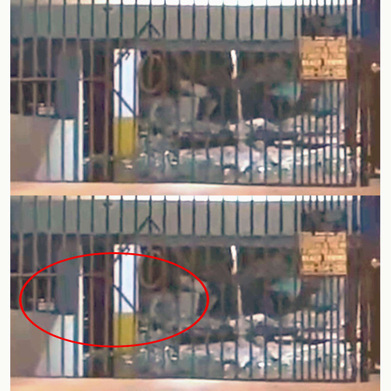

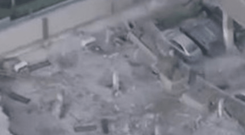

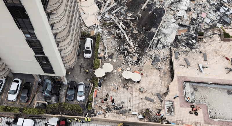

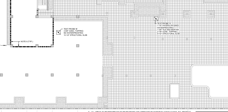

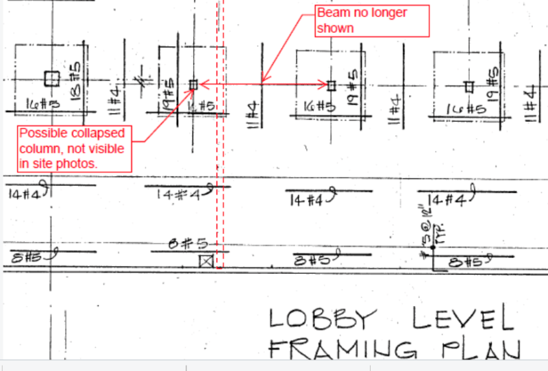

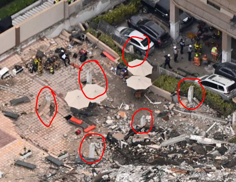

On you marked up drawing of 1 Jul 21 21:43 post you indicated a column adjacent to and outside the un-collapsed building not visible and could have possibly collapsed.
There are evidence that this column had punched through the pool deck slab just like the rest of the other adjacent 6 columns nearby. In the Morabito drawing this column lies at the border fence of the bush area.
It is shown up in this shot. You can see its top just next to the parked car.
Another photo shows it is covered by the displaced fence but at 20' c/c distance with the other two columns you can make out it is there in this photo.
DB27 said:
It's also interesting that many of the columns remain, but I don't see evidence that K/14.1 is still standing. If the beam at the slab drop (K/12.1 to K/16) failed at mid-span due to the missing beam, it would create a sudden eccentric load to column K/14.1, possibly causing it's collapse.
Column K-14.1 is still standing (visible between the fence and gray car):

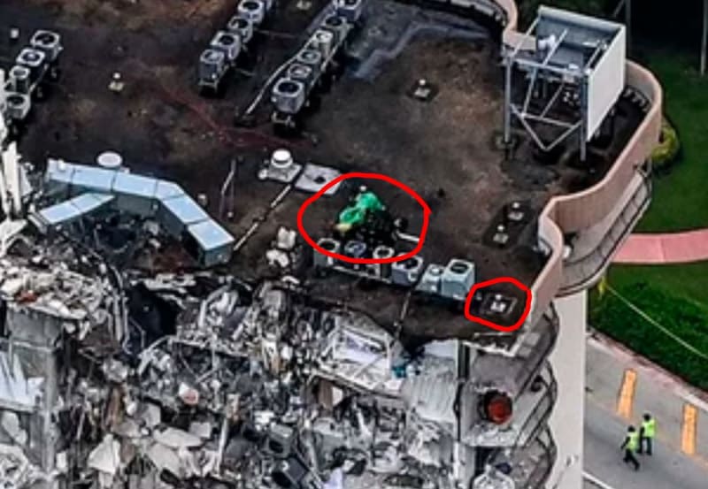

Roof work was actively occurring, the building's new roof anchors were inspected by a city inspector, Jim McGuinness, on June 23, 2021.
Well look here... The roof anchor permit was issued by the city on June 23, 2021 to Concrete Protection and Restoration, LLC. Link The building collapsed on June 24, 2021, at approximately 1:30AM (less than 24 hours later.) It's possible the initial work was unpermitted, I doubt they could have installed all of these roof anchors in one day. The town has not posted any other roof anchor permits I can find.

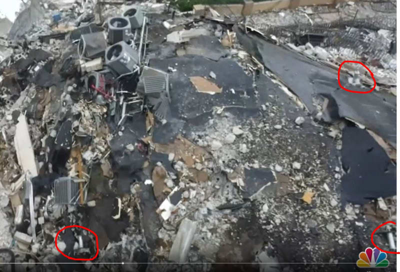

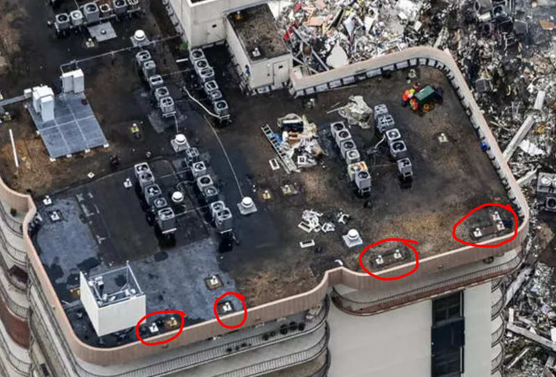

Roof anchors visible on collapsed penthouse roof:

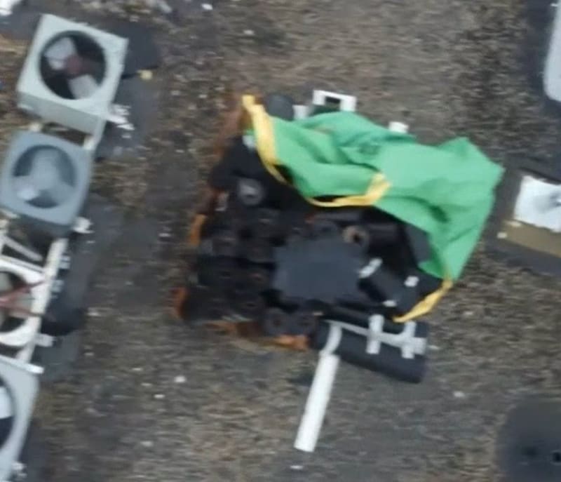

Work was not complete as rolls of roofing paper are visible on the roof of the remaining portion of building directly adjacent to the collapse (left circle below) and improperly installed roof anchor (right circle below further discussion below):
Close up of roofing paper from drone video - note the green plastic looks similar to that seen in the garage in the tiktok video:

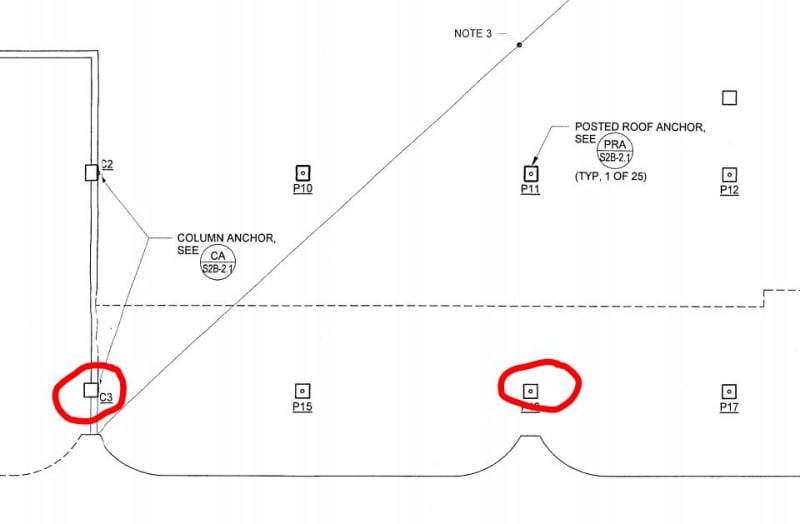

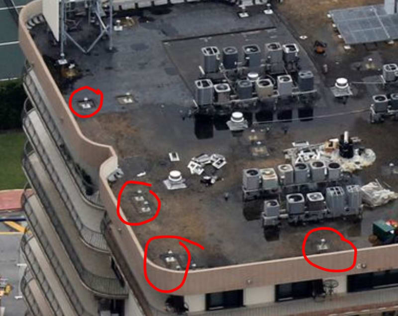

The penthouse roof anchors are to be on or between the columns, not on the cantilever portion of the slab (the two anchors circled are the two columns which failed first in the surveillance video):
The roof anchors were improperly installed on the cantilever portion of the rooftop slab in the portion of the building that did not collapse:

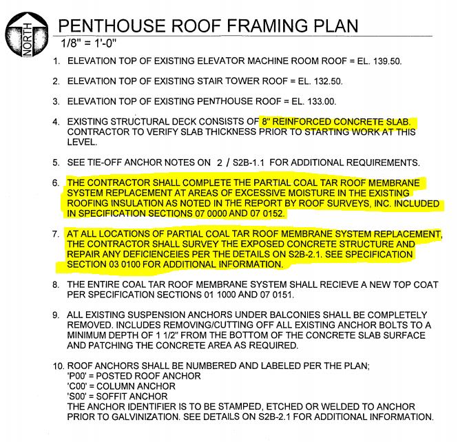

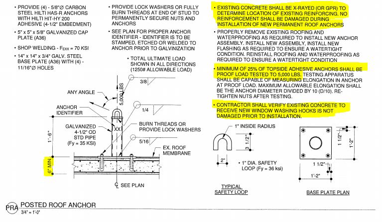

Roof anchor drawings note required repairs of concrete and a slab thickness of 8" - to be verified (how exactly is a roofing contractor supposed to verify a slab thickness?):
Post roof anchor detail notes 6" slab, states anchors should not be installed on damaged concrete, slab to be xrayed, and notes 25% of anchors need to be proof load tested to 5,000 lbs.
I believe the roof anchors over the penthouse were installed incorrectly, the first bangs of construction Ms. Nir heard was pieces of the roof falling off onto the pool deck. This caused the pool deck to fail either by hitting a column in the parking area as the ENR article suggests or by overloading the slab.
Please poke holes in this...

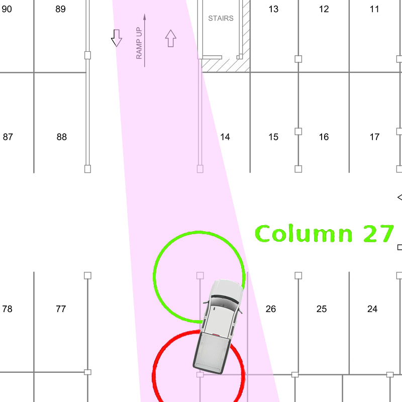

Devils advocate here. Is this the pickup truck/vehicle that struck the column and knocked down the tower?
Motive, perhaps a disgruntled unit owner angry about the special assessments they are about to face?
All of the other deck area columns punched through the slab whereas this one appears to have snapped as though taking a lateral load.
Truck to same scale as plan
I totally apologize but I really don't see any "mechanical roof anchors". To me the term infers a mechanical connection between the base-ply and the underlying substrate, and not the connection for A/C stands, flashings or caps. The term mechanically fastened roof makes me think of anchors on a foam or thin lightweight concrete over a metal deck and not a pored a RC deck.
The roof anchors I'm referring to are OSHA fall-protection roof anchors.

There are absolutely no OSHA deck anchors in this structure.
Scroll up to warrenslo's post at [2 Jul 21 00:27]. warrenslo is talking about the anchors that had just been/were being installed on the roof. I believe they are window washing anchors/davits, but the 5000lb ultimate load spec'd on the detail might lead one to believe it is a fall arrest anchor. I don't know the difference between the two though (load rating of a window washing davit vs fall arrest). Never designed one.
That is interesting. I still have a hard time believing that hammerdrilling 4 ~3/4" diameter holes in the roof slab would cause the balcony/roof slab to collapse. Which balcony's roof are you proposing fell first? Also, I doubt a falling chunk of slab would be able to bump sideways into a column hard enough to buckle it. If the piece was large enough, and it landed directly above one of the columns under the pool deck, perhaps it could cause some manner of crushing? I think it's far more likely (if a piece of the roof fell off and landed on the pool deck slab (+11'-10")) that it would have caused a punching failure as opposed to damaging the column somehow. Part of the slab collapses > triggers domino effect as the falling slab drags down the adjacent slab (slow or fast, who knows) > etc

Keith_1 said:
There are absolutely no OSHA deck anchors in this structure. I don't know what scares me the most is that you have absolutely no clue when such things are employed, or how they are employed.
This is a simple midrise, there are absolutely no geometric point that OSHA would require an anchor point for a complex geometry, nor is it tall enough to require a secondary anchorage.
I certainly do have a clue, I have designed many multifamily apartment/mixed use roofs with anchorage systems. They are required on buildings of approximately 5-stories or more in height now. CA is especially strict after Jerry Brown cracked down on the law not being enforced.
There weren't OSHA anchors on this structure until an unknown period shortly before collapse. They were in the process of being installed to facilitate the painting and repair of the decks and concrete walls. The permit pulled the day of the collapse was specifically for OSHA fall-protection anchors. Please see my post above for the permit info, etc.
[URL unfurl="true"]https://www.osha.gov/sites/default/files/publications/OSHA3146.pdf[/url]
