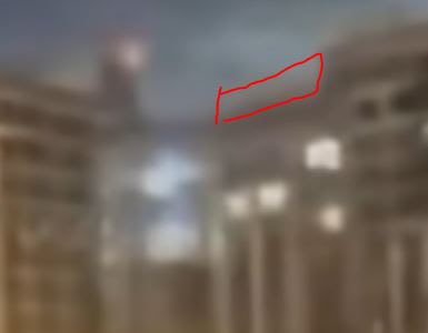

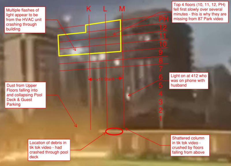

Surveillance video seems to confirm top 4 floors over x11 stack fell first - this was where roof anchors were being installed above the penthouse. This roof area is under structural columns in the debris pile closest to the guest parking.
If you’re looking at the footage that’s had the beginning trimmed (the uncut version starts with a no signal white screen), key frames showing the bottom of the x11 stack between L and M falling initially are missed.
The flashes visible are the Fire Alarm Strobes illuminating.

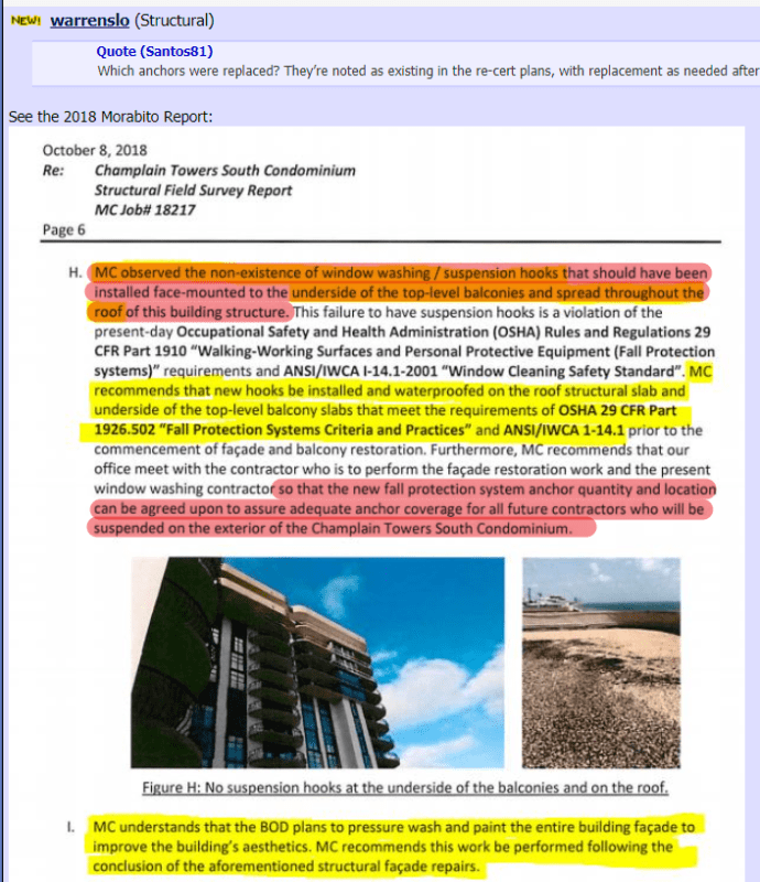

Which anchors were replaced? They’re noted as existing in the re-cert plans, with replacement as needed after field check and necessary condition repairs to the slab performed.
See the 2018 Morabito Report:
Here's a slightly earlier screen cap, The top 2 floors (possibly 3) are clearly missing over the x11 stack. I think they slowly fell in pieces over several minutes prior to the main collapse causing the damage in the Tik Tok video. The Penthouse and Floor 12 had large catilever balconies across the entire unit on the x11 stack. The two white flashes are either the HVAC or electrical flashes. The prior image I shared was milliseconds later and the floors with lights on hadn't moved yet however the 10th floor light goes out by then.

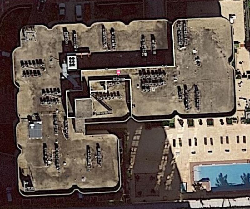

The anchors did not exist in this Google Maps image dated 2021.

They installed nearly all the perimeter anchors on the cantilevered portion of the roof slab - not per the structural drawings.
But there was no load on the anchors last Thursday. Are you saying that the installation damaged the cantilever portion of the roof? Do we even know for sure where the anchors were installed? That would be a pretty big error on part of the anchor company, as they had drawings to guide them. Did the city building inspector note any problem with the location?

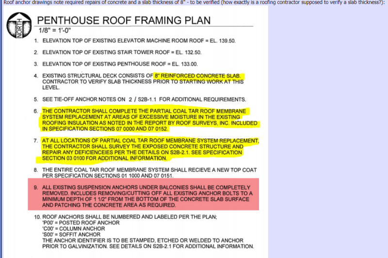

I'm not sure exactly what the permit was for, as there were clearly new anchor point 'posts' installed prior to the collapse. But I can tell you with certainty that plenty of work gets done without a permit. Maybe this most recent permit was an extension of a permit issued prior, or something to that effect?
Also, the 2018 report indicates there were no under-mount/face-mount suspension hooks (sketchy) installed under the roof level balcony covers. See my red highlights below from warrenslo's posts above. Yet they indicate (second pic) that existing under-mounted anchors be removed and the anchorbolts ground out 1.5 inches above the soffit. I'm confused.
